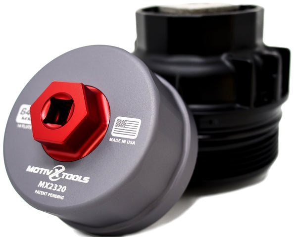

MotiveX makes good stuff. They recently have converted their entire lineup of cup type oil filter wrenches to made in the USA from billet aluminum oil filter wrenches. I have one of their 64.3mm cup wrenches for the oil filter on my 2021 Toyota Camry. Best made oil filter cap wrench I've ever seen.
