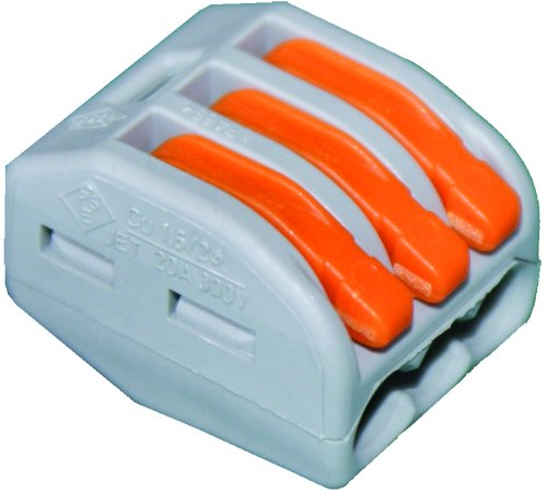

Sta-Kon are fine, so are T&B, Panduit or most others on the market. You really don't need insulated or shrink tubing in your application. As long as there is no danger of the terminal touching any metal once they are plugged in, there is no benefit. You should turn off the power before working inside the starter enclosure, so no need for the insulated versions. If you cant find uninsulated, then use the simplest insulated versions you can find.
You already have plenty of uninsulated points of contact inside that starter enclosure, what's a couple more?
For connecting the motor wires, there are a variety of ways to do it, but for smaller motors, I really prefer Wago Lever-Nut connectors.
Available in two pole to five pole configurations.
