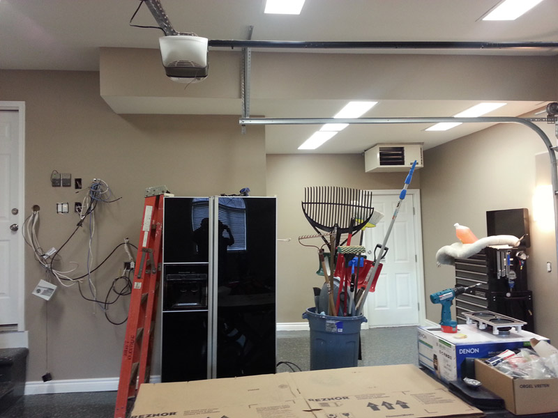

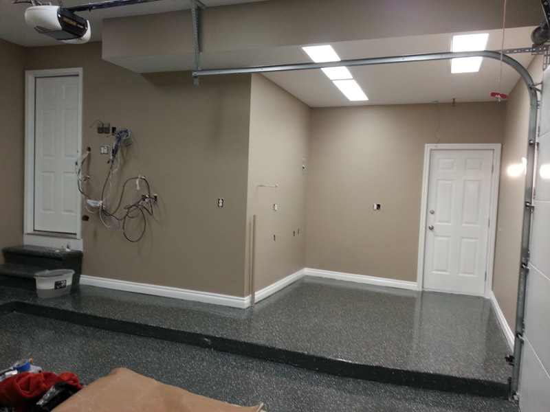

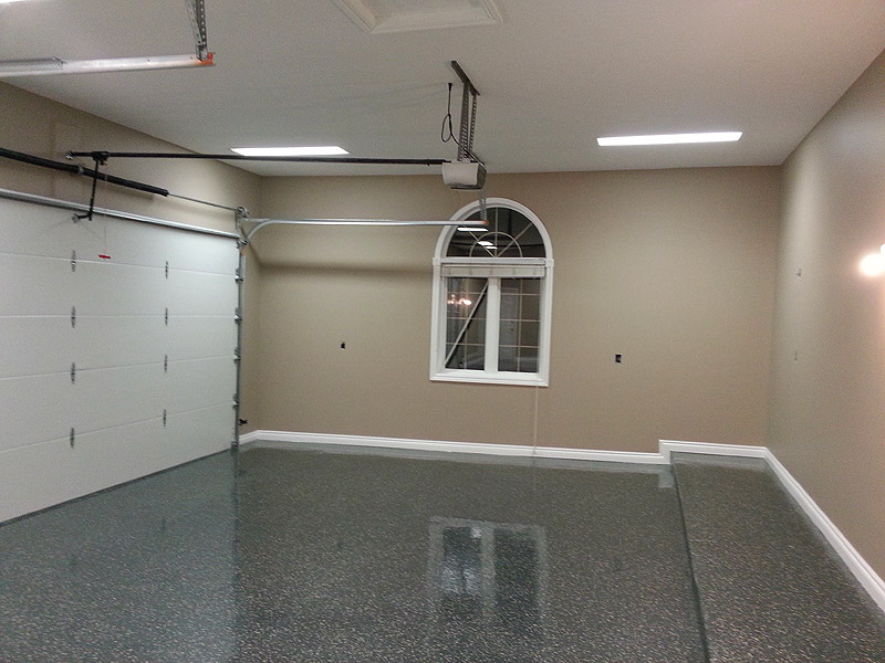

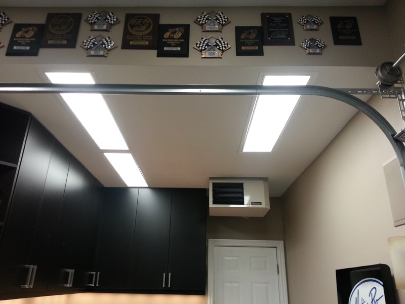

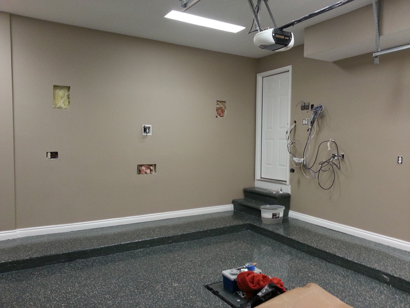

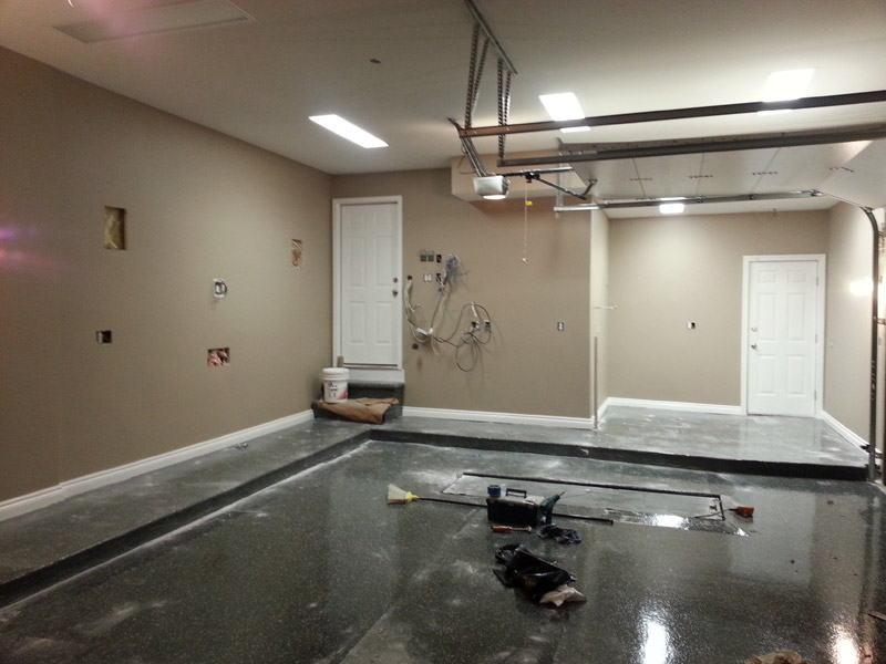

With drywall finally finished and primed, paint color was chosen and off we went. The ceiling would remain white to match the ceiling lights and I wanted something neutral for the walls, but not something cold. My previous garage was all grey/blue and it had a cold feeling to it, so I wanted something with a little warmth. I sorted through colors and picked one I thought would work. From the photos below, it came out nice without question, but it really isn't the color for the bike workshop/garage concept I had in mind. I wanted something more grey/industrial-looking. Oh well.

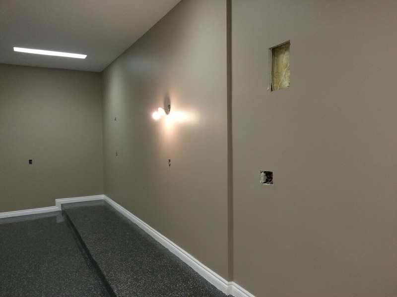

Another thing of note are the wall lights. This was another add-on that ended up being a good idea. The 10 overhead lights are great for overall light, but in the summer when the garage doors are open, a good portion of that light is blocked. The four wall lights (two on each end of the garage) provided added light. As an electrician's son, you can never have too much light. I'd like to find some nice, industrial-style fixtures at some point, but the ones I went with were inexpensive and would make due for the time being.
Overall this completed a major phase in the whole shop project. The garage was starting to take shape and come together. Of course, I didn't have any tool storage or cabinets yet, but those were next on the list ..
Paint complete:
No more holes:
Good lighting was the goal:
Speakers ready to be installed:
Cabinets would eventually wrap around these walls:
Rear speakers ready to be installed. Subwoofer down low:
A sink/wash station will eventually go along this wall I hope:
That back door was flipped to open out rather than in, then painted white. Also added a dead bolt for added security:
Fridge, then power for future under-cabinet lights, power down low for an air compressor, HDMI/ethernet for a computer hookup and sub-panel in far corner. Also note power coming from PVC in floor for lift table:
Next up, cabinets.

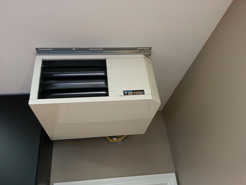

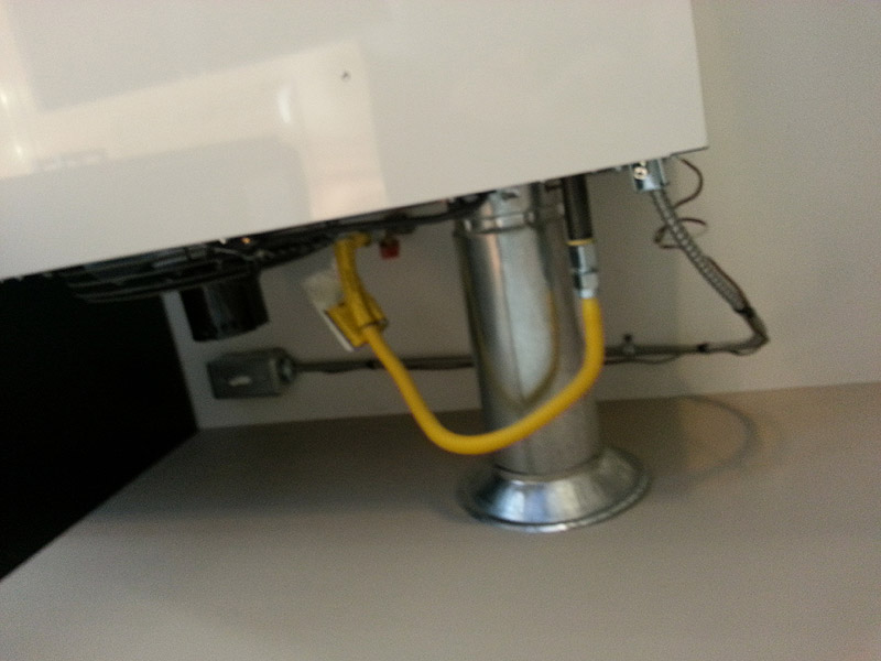

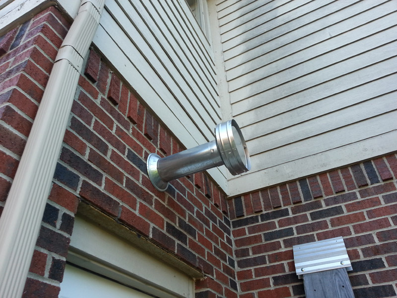

Cabinets were next, but in the meantime it started getting cold out so the heater was bumped up in the priority list. I have a friend in the heating and cooling business, so he provided a really good price on a Reznor heater, 45k in size. Through measuring and checking specs on all the sizes, the 45k would be ample in size and the throw would reach all the way across the garage to circulate heat to the far side. The thermostat was run over by the A/V center so all controls were in one nice and tidy spot. We also installed a ceiling fan to help circulate air. Overall the heater is extremely quiet and barely noticeable when kicking on.
The insulation has proven its weight in gold thus far. In the cold Michigan winters here, the coldest the garage has gotten without heat has been 50 degrees. I was pretty surprised by this and borderline excited, which is a little weird. With the heater cranking, it will stay at 70 degrees easily, only having to then kick every once in awhile. No more draining the water out of the bikes in the winter to prevent them from freezing when the temperatures drop below freezing in January/February. Yeah to me, this was exciting.
Reznor heater in far corner:
The fins were red originally - painted black to match the color of the future cabinets:
Poor photo, but shows the wiring behind the heater:
Vented outside:

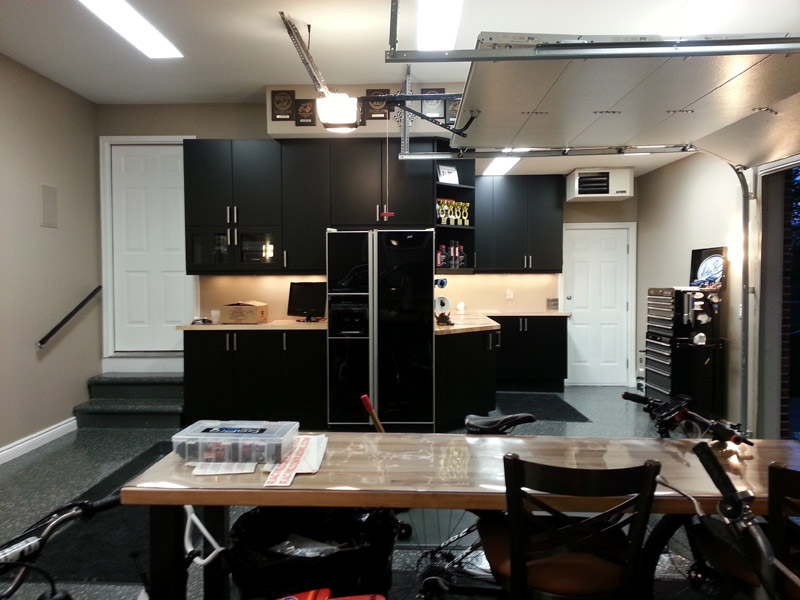

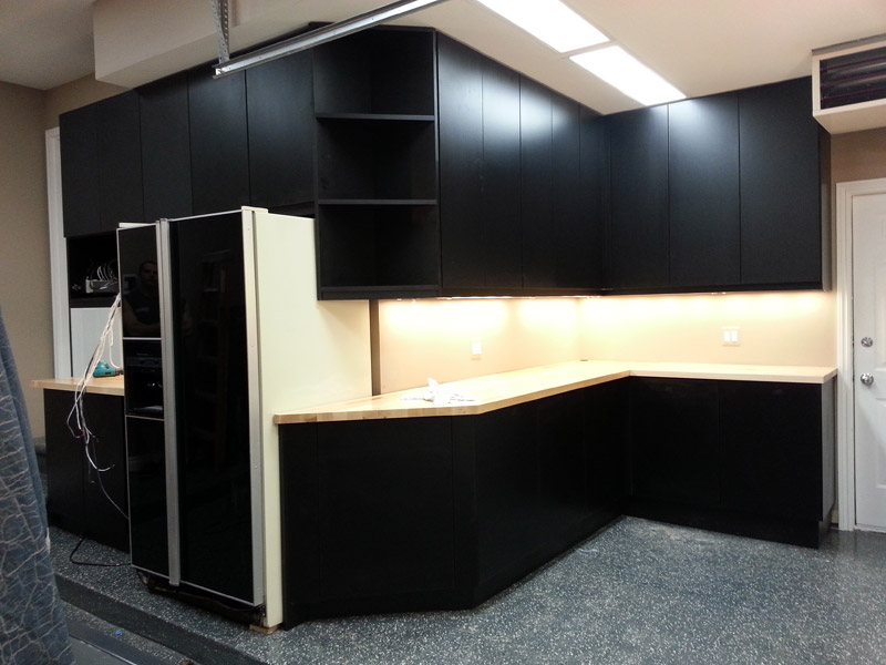

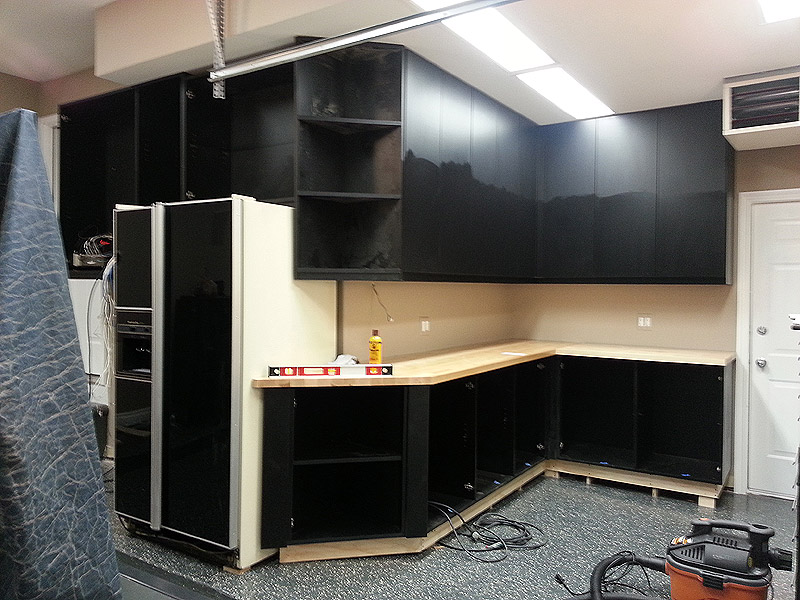

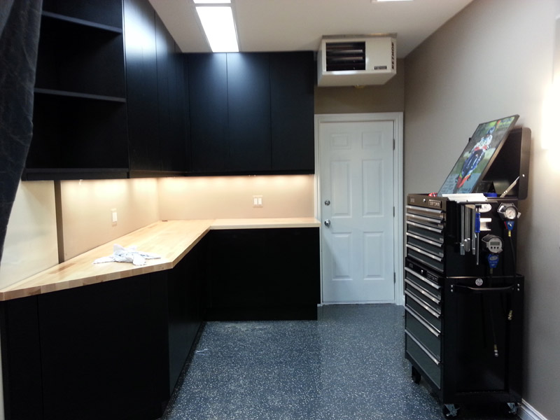

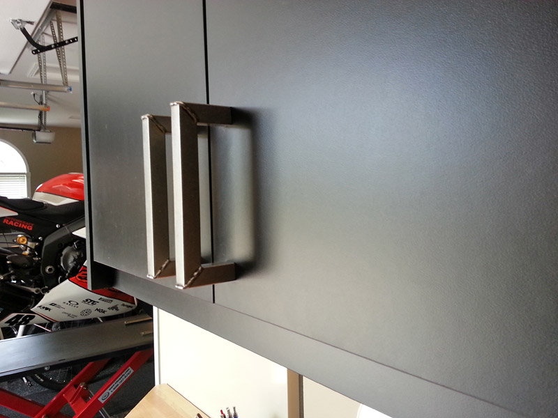

The cabinet install happened over the course of about a month. From measuring, to figuring out materials, to getting the guys out here to install them, etc. - it was a process. We kept the cabinets simple, as there were a lot of them. I wanted upper cabinets to wrap around the workshop area, with base cabinets to match - going fully to the ceiling, minimizing dust, bugs, etc. from collecting above. The cabinets are a black melamine, using hardwood rather than plywood to minimize expansion/contraction on changing weather/humidity conditions. My dad does work with a builder who did the cabinets here. He does many retail eye center offices in the area and did a great job IMO.
Again the slope of the floor provided a challenge, but everything was leveled with a toe-kick, ranging from about 2" on the short side, to nearly 5" on the far side, but it's not noticeable unless you're really looking for it.

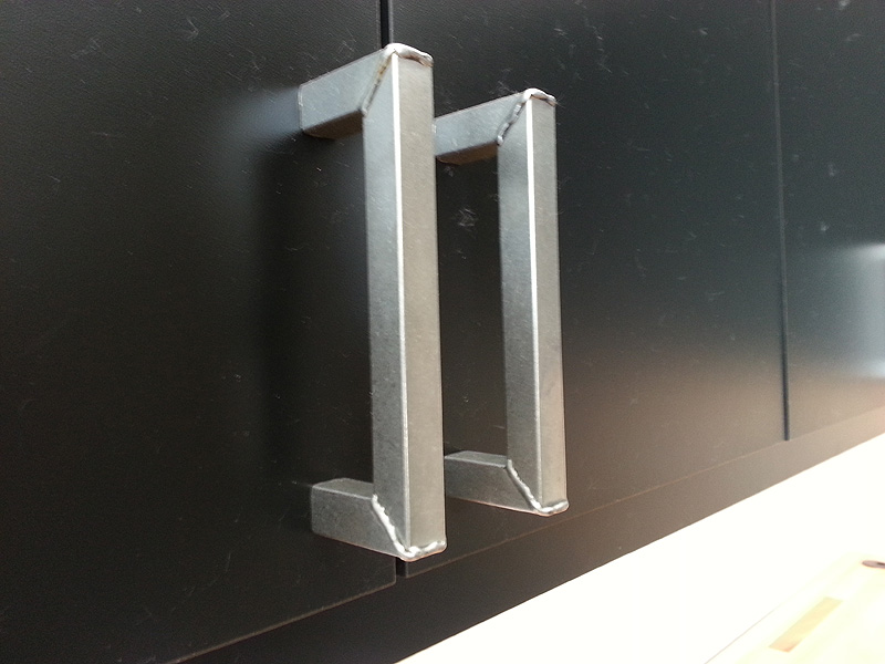

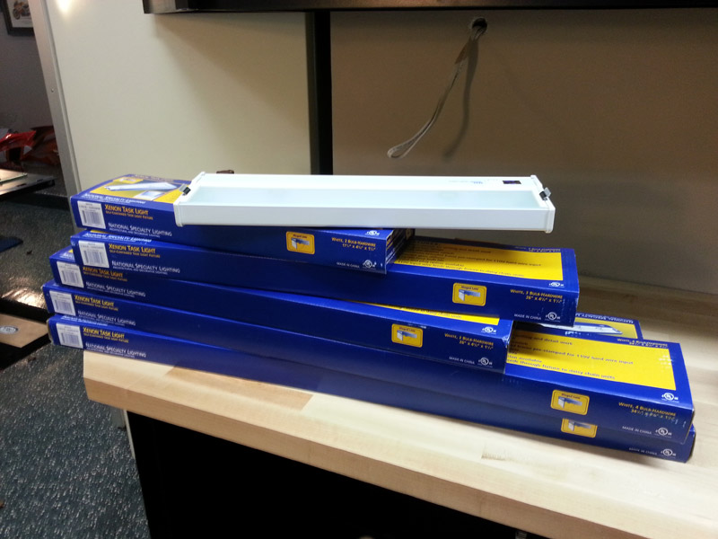

For door hardware, I picked an industrial/welded handle. Clean and simple. We also tucked some Xenon under-cabinet lights in - again, scope creep from the original project plans.

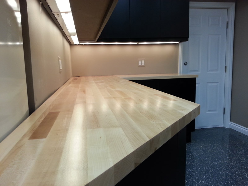

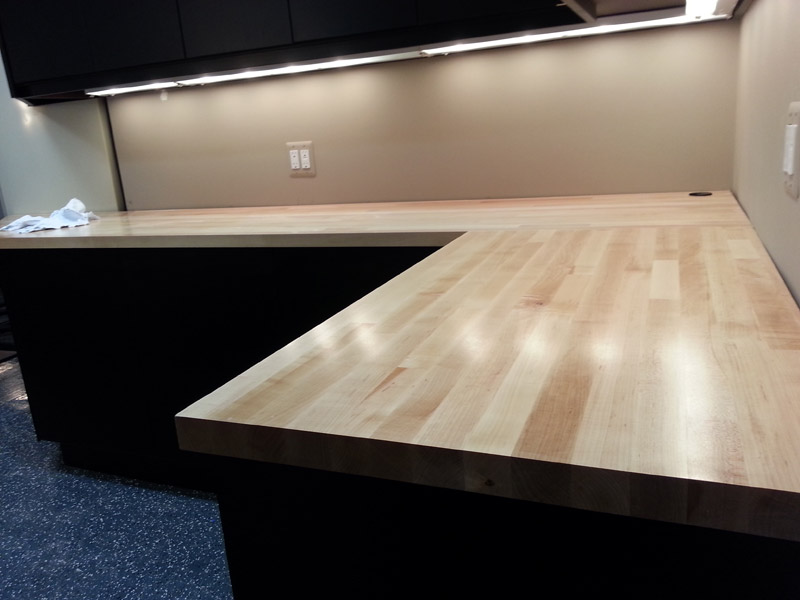

I went back and forth on counter-top options and settled on butcher block. It looks good and cleans up well. I'd like to eventually sand and stain them a darker color, but for now it works quite well. We did our first bike preparations after this was done and used nearly all of the counter-top space, tearing the race bike down to the frame, going through it and putting it all back together. It was the first time not working in dad's garage. I was a little bummed.
Start of upper-cabinet install:
Upper and base cabinets - notice toe-kick to account for floor slope:
Doors mounted up:
Note toolbox on right. Craftsman limited edition box that was surprisingly good quality:
A/V cabinet wiring. Glass door to be installed so remote works with receiver:

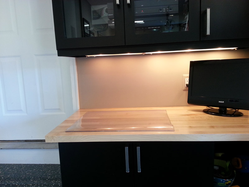

Original ceiling light measurements were accurate:
Under-cabinet lights:
Installed:
Another angle. Computer monitor will eventually go in far corner with PC underneath:
Cabinet door hardware:
I'd like to do additional cabinets on the opposite wall (with the window) for non-shop stuff, like rakes, shovels, bicycles, parts bins, etc. but this amount of storage was plenty to get started with.

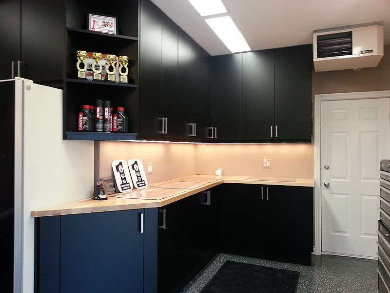

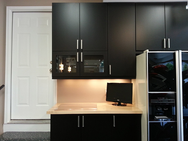

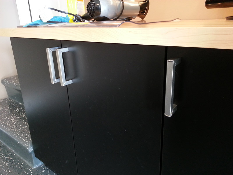

Here are a few more showing the cabinets:
Butcher Block top on base cabinet:
Pulls:
Made the corner cabinets on a 45 for easy-travel when walking back and forth. Thinking about putting a vise on the bench there eventually - good location?
A/V cabinet - ethernet switch to power three locations, including stereo receiver for Sirius/XM radio feed. Note sprinkler control box at bottom of photo - this was relocated from another wall to bring everything control-related into this cabinet.
A/V cabinet complete:
Monitor doesn't do anything - it's there temporarily to test the HDMI inputs:

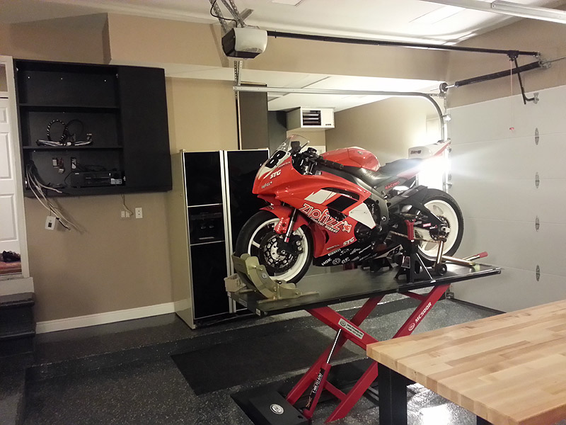

Note the clear work pads. Thick and durable when hammering out and installing wheel bearings:

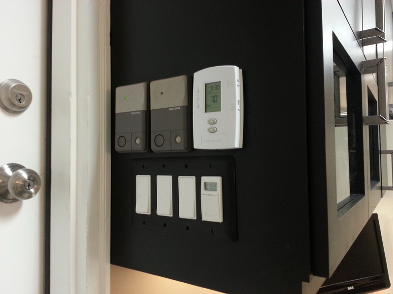

I had drawn out plans and measurements to build an 8' workbench for this area of the garage. Then Sears put this Gladiator workbench on clearance for a price I couldn't touch if I wanted to build one myself. It's 8' long with a powder coated frame, adjustable legs (to accommodate the floor slope) and a butcher block top that matches perfectly with what I already had.
Garage doors, thermostat, wall lights, under-cabinet lights, shop lights and outdoor lights:
Just about finished:

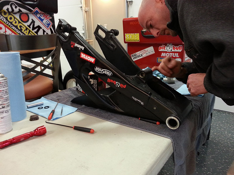

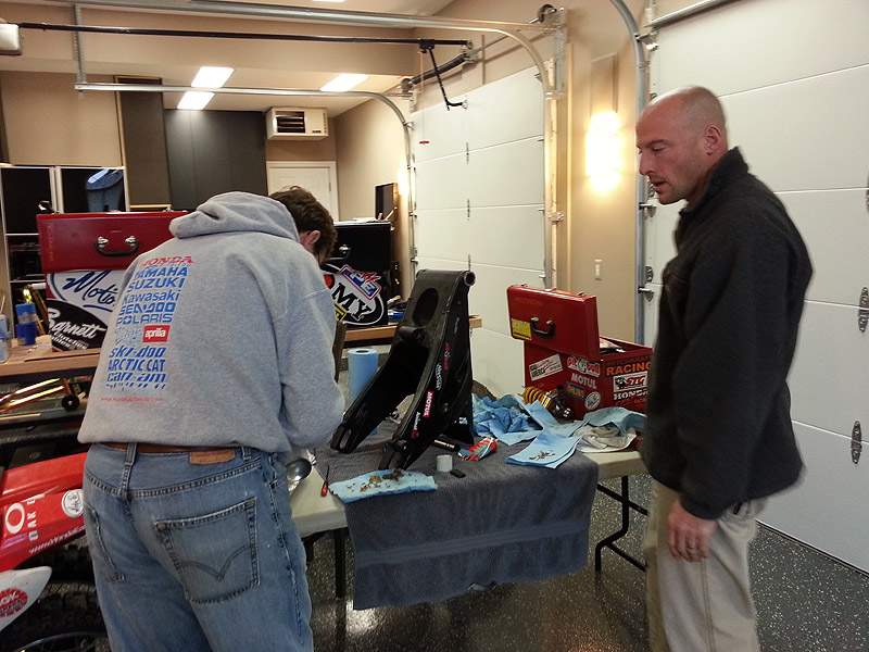

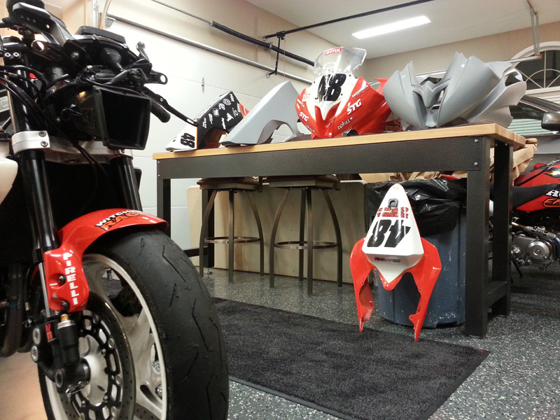

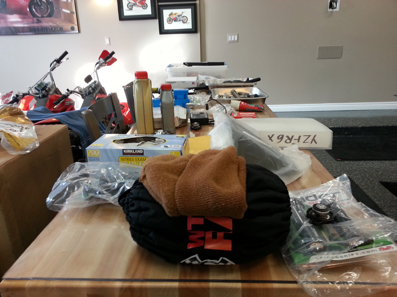

Thanks guys for all the positive feedback. Here are some photos of the crew working over the winter to prep the bike for this season.
Long-time friends and racers, Doug and Aaron - along with my dad:
Table of parts:
Temp table - there's never enough counter space!
Aaron prepping the swingarm:
These were taken this past January - cold temps with the heater doing its job. We typically take everything apart, down to the frame. We do all the work ourselves minus the engine, as we have an engine guy who builds all our motors. It's something we'd rather leave to those more knowledgeable than us, in that regard.
