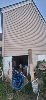

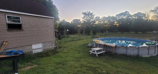

D
Oct 4, 2021
9
I would also entertain the thought of adding a "deck" to the side of the garage for the length of it over the lower yard area maybe out 8' from the garage. Then put a porch off the entire side of that garage.
That's what we are hoping to do in the future to go out to the pool and incorporate the garages basement somehow. Unfortunately the garages basement is full of junk (old lathe, wood, car parts etc) that's buried in about a foot of dirt/mud from flooding about 6 years ago. Graded across the street for a culdasac and didn't put any erosion barriers up so everyone along the street has bad basement flooding that year. Don't mind the mess 😂
