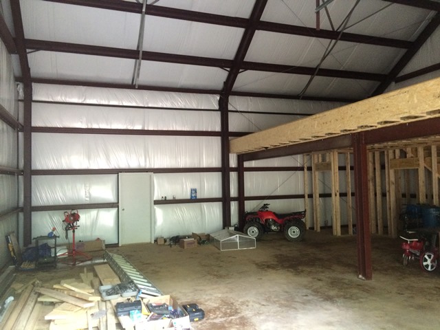

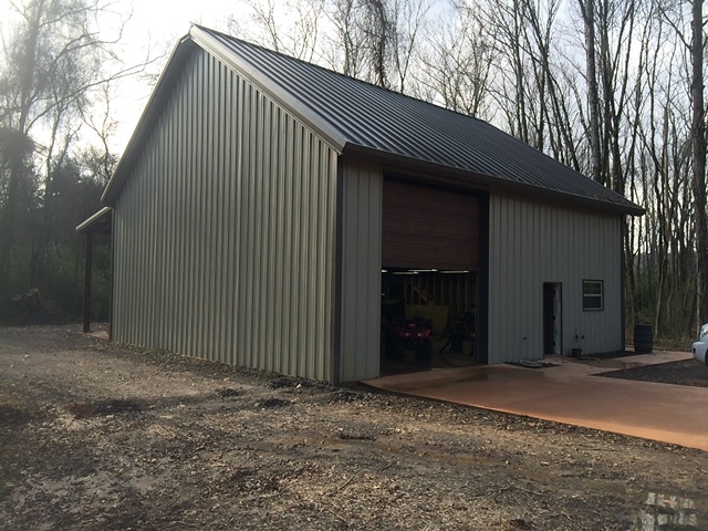

I just ordered a MrCool 36k DIY unit to cool my 40x40x16 shop. It's insulated pretty well, and 1/2 the shop has a 10' ceiling. Pretty high pitched roof, but I'm thinking that won't matter much since heat rises.
Looks like I'll be the one giving these MrCool units a torture test :)
Will report results as soon as it arrives / gets installed. I'm planning to install the unit on the "right" wall high and center. That will keep the area under the upper floor more cool, I'd think, and still cool off the high-bay area too.
Shop has a lot of shade .. usually stays about 10 - 15 degrees under outside hottest temperature.
I'm less confident about it's ability to keep this place warmish in the winter, but I'll cross that bridge when I get there.

Yeah, really thought your metal building was going to be a challenge, but looks pretty well insulated. The high ceilings were the driver for me to go to an 18K unit. Jealous of your space, that's a nice size.
