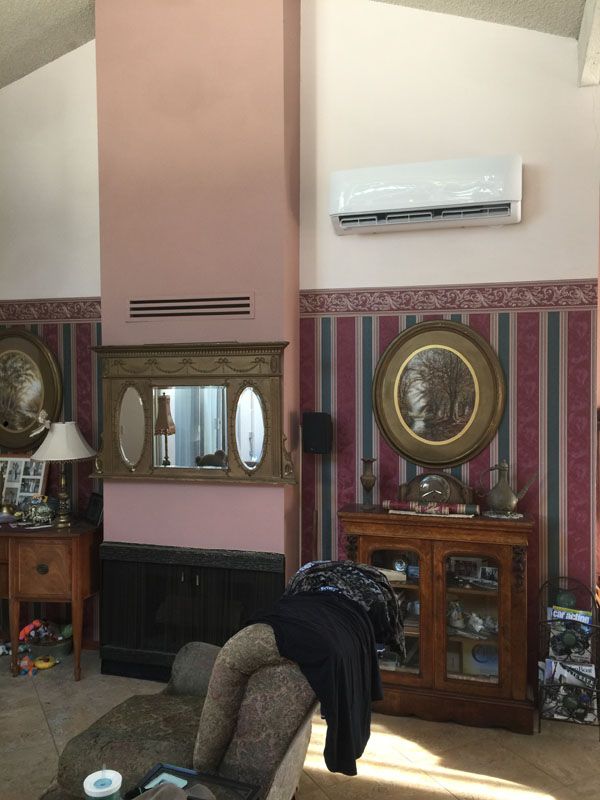

Installed Mr Cool 18k DIY in April. Works like a champ!
It was the perfect install where the lineset is extended the full length of 25' over only a 3' rise.
I really like their phone app. Simple and easy to use. No muss, no fuss for quick changes. The supplied handheld remote is rarely used.
Possibly a bug in the "follow me" feature for the remote-- tried using this because the built-in thermostats in the head units aren't super accurate-- if you're blowing 60 degree air out a huge vent, what is a thermostat going to read being only 8" away?
The above is the only design flaw as I see it but that issue is inherent in all mini-split systems which run an algorithm from a built-in thermostat. Seems like the unit over-cools or takes too long to cool the room down.

You will always have temp variances within your living space, just a nature of the way these work. The follow-me will use a temp sensor in the remote. I find it doesn't make much difference actually.
The room temp sensor is the black antenna thingie behind the cover that sits just above the cooling coil in the air handler. It's going to sense room temp as the air is drawn into the blower cage.
One of the issues I have with my main 2-ton unit is that it's nearly 10' up the wall with 18' ceilings, so there air is always much warmer up there. We don't have to set the temp control as low to get a comfortable room temp at floor level. The cooler air does sink, it's coolest at the floor - and with all tile floors over concrete slab, if the house is kept cool over several days the floor acts as a heat-sink, or I should say 'cool-sink'.

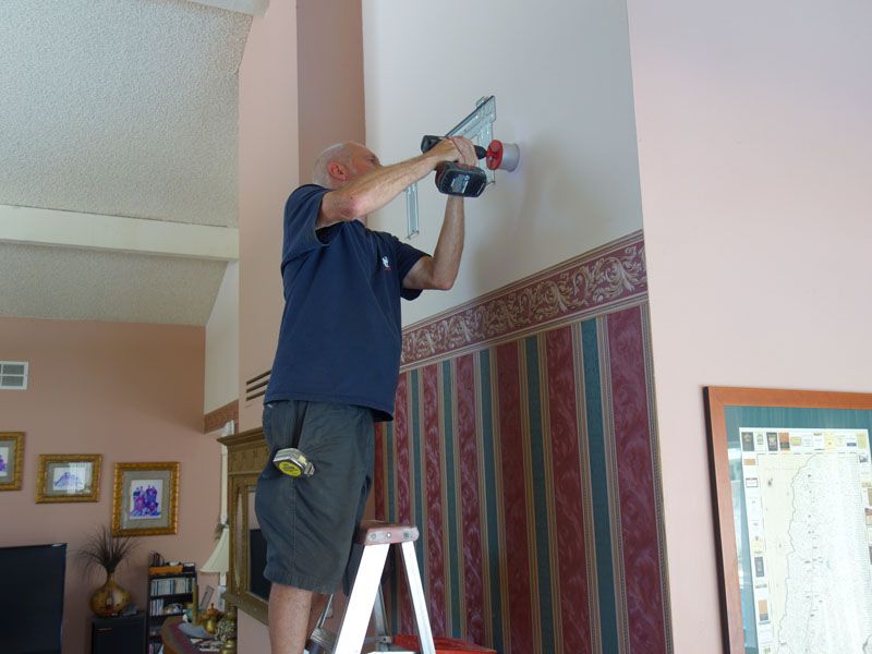

I'm pretty handy, have built boats and cars and airplanes, houses, a DIY extraordinaire. Installing a minisplit is like child's play. I just sweat a lot. LOL
I got quotes for both brands from 4500 to 5500 for an installed unit, pretty much regardless of size. And the sellers I spoke with aren't all that enthused. The entire industry is built on sending a couple of guys out for the day and raking in five grand or so in profits. And why you hear so much negativity. "Women hate the look of that air handler on the wall". Really?? My wife doesn't give a ****. LOL Or the famous, "Oh, those aren't very reliable". Really again? Why are you selling them then if they aren't reliable? Everywhere you go around the world these things are hung on the wall, cooling the place. Millions of them.
And I love the "We only sell Mitsubishi, they're the best and we have the best luck with them." Do you understand they are twice as much as everything else?
I talked to some real bozo's in the biz. One guy came over from Home Depot, spent three hours trying to convince us to spend $18K on a hvac system. Even convinced the wife to serve him a dinner taster of what she was cooking. Of the many comments, one was, 'you better jump on this now or we'll be all booked up'. I should have thrown him out much sooner. Another claim was that he was 'retired law enforcement and he just does this on the side to supplant his income'. And that he started a limo company that his daughters run. The guy was a real sham.
Then I tracked him down on FB where he posted how he had made a killing selling AC units - like five or eight grand in one day. What an idiot. GTFO. LOL

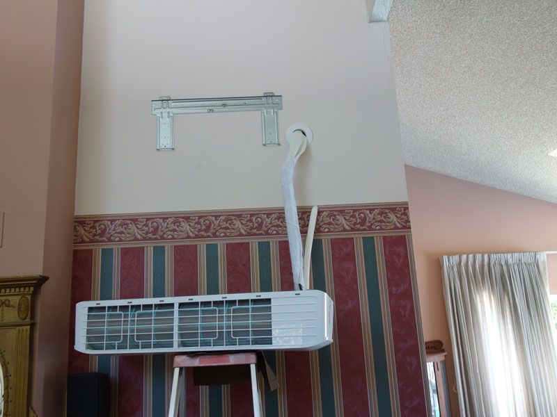

Here you can see I have to lift this 38lb unit with the rigid section of lineset, out and straight in, on a 8' step ladder. Talk about a trick. :scared:

Browneye: There is no "flex part" in real terms .... in a perfect world there would be. Moving the line set and over flexing is a common cause of leaks -- it puts pressure on the thin wall copper. With the constant temp changes adding stress over time ---- leaks.
Also -- when you get around to doing the duel head make sure you get and read the manuals. The sizing of the head and compressor and operation is a bit different than the singles.
No, the MrCool line set is a flex line. Looks something like this:
Depending on the construction -- the inside line is corrugated copper. I know some of the early ones that used EDPM were pulled from the market.

And an update on my warranty replacement saga for 2 year old unit...
As mentioned previously, getting into the third season of cooling with our 2-ton unit, it wasn't blowing cold, and icing up, so a tech came out and charged it, tested and found a leak where the flex line meets the rigid section at the air handler.
It took 3 weeks to get a warranty replacement from Ingrams', that being due simply to a backlog of orders shipping out. It did finally arrive, a no-charge invoice for a new air handler, and I removed the old one and installed the new one.
It worked great but not cold enough. I was pretty sure some freon leaked out between the time the tech charged it and I determined I was getting a replacement - and so I turned of the gas valves at the compressor unit. Fortunately we had a solid week-plus of cooler weather so we didn't need AC.
Saturday my tech came back out and put his fancy gauge on it that shows all the pressures and temps, and that is how he determines freon level - temp drop from liquid line to air output, etc. Anyway, it was about half down on freon so with another pound of gas or so the thing is working stellar now. Output air temp was about 68 degrees, now at 54.
The only drawback for the DIY warranty claim is troubleshooting and diagnosing the problem, and then waiting for and doing replacements. This process took us about a month. So it's no quite like calling your HVAC contractor and they show up the next day and fix your AC unit. But we're happy nonetheless, and our house is a balmy 75 degrees on a 90 degree day.
All's well that ends well, eh?? :rocker:
