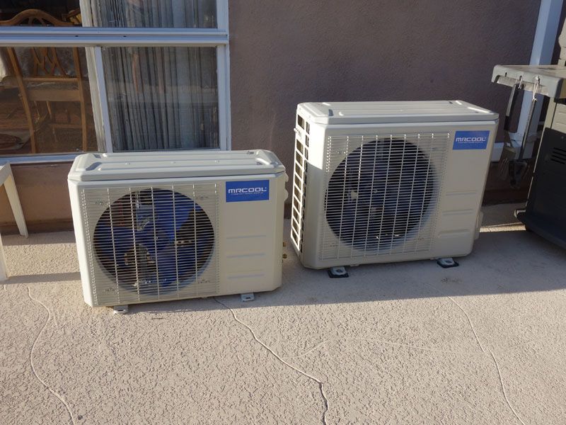

Done and cooling. Took two half days, mostly because the shop is full of big heavy **** to work around. Setting up a ladder is a challenge.

3 ton. It cooled the shop down pretty quick. Nothing particularly difficult about the install. The 36k head is a handful to climb a ladder and hang by yourself. We'll see how it does when it hits 100 again. It pulled several gallons of moisture out pretty quick.

Yeah, the 3-ton compressor unit is the same as the 2-ton, but the air handler is 49" long vs 42", which is the same as the 18K. The 1-ton is 31" - much easier to handle.
I had quite a time getting ten feet up a ladder with it, while feeding the lineset through the hole in the wall, and then getting it hung on the bracket. I sweat like a pig. :bounce:
Compressor units - 1 ton vs 2 ton:

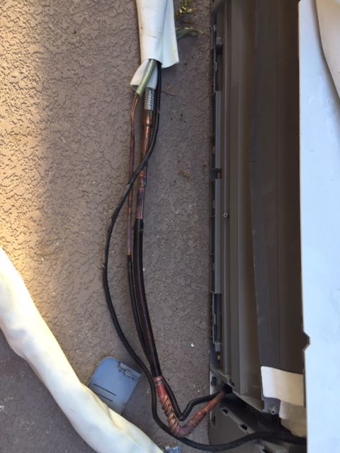

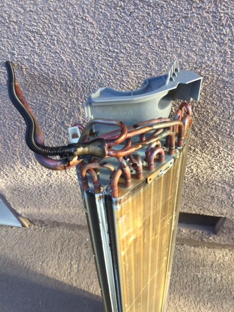

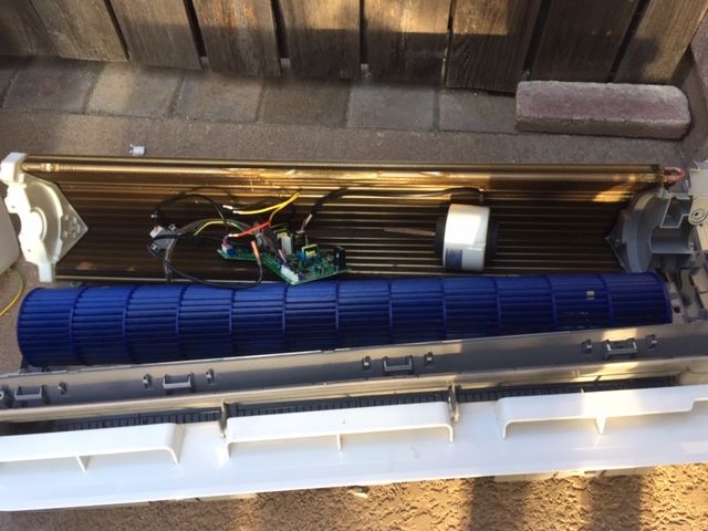

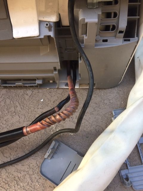

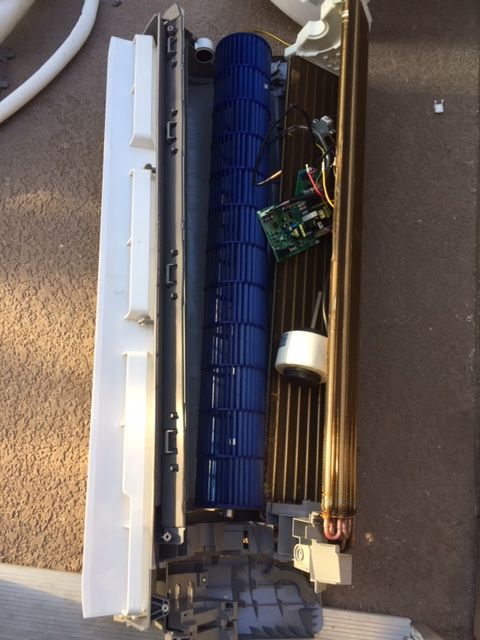

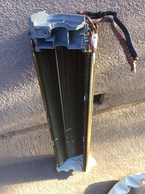

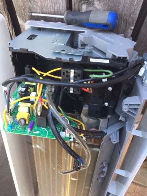

Okay, so I decided to explore a little more into the flexible lineset on the DIY MrCool, since I now have a new air handler, replaced under warranty.
In disassembling it, I found it to be very easy to take apart, and that overall the design and engineering is very good. They really are pretty simple once you see inside them.
Here's how the lineset is attached to the coil - yes, it's all one piece. My assumption is that the flex part of the line is welded on after the air handler assembly is built. Even the hard part of the line near the coil, would be very hard to kink when handling it for installation. The piping is corrugated and it's very strong - I folded it over several times and it took a concerted effort to actually get it to kink. Both lines had anti-kink coils installed on them before assembly - they're what look like black covers:
The plastic housing has three screws in the front, two under tab covers in the lower lip, and one on the front behind the flip-up door. From there, just a couple of screws the the covers come off and the whole control board just slides right out. There's a terminal block that connects the controller wires to the board, and a couple of screws and the motor housing and door actuator motor just pop out. Same for the fan cage, it just slips right out with the end bearing set. Super easy.
I decided to hang onto the electronics and the motors as spares. Kept the front door and the blower cage - can sell those as spares. In particular, the front door is flawless - they are easily damaged in shipping, so surely someone along the way is going to need/want a replacement door.
The cooling coil is a very simple affair, and nicely made. I suppose it's possible one could get a leak somewhere in this assembly. It's really durable though.
Hopefully this answers some questions on how these things are put together, and confidence to tackle the job of disassembling one for repairs if necessary. Replacing any of the components is actually pretty easy, board, the motors, etc.
And let me know if you need some parts for a 2-ton DIY. :thumbup:

So where was your leak?
The units come with the first flex ..... it's attached to the heat exchanger prior to assembly.
The DIY are post factory products -- they have the line set and any other provision for line movement (flex) installed after the unit is constructed.
The corrugated extension allows for kink free adjustment -- but it's still firm enough to damage the exchanger if you don't support properly.
Normally -- the stub piping would all be open and visible. With the attached line set being covered most don't understand you have to be careful ... just moving the line set transfers back to the heat exchanger

In my case, the leak in the lineset was right at the junction of the flex part to the fixed part, liquid line. Or assumed to be. A tech used an audible sensor, and that's where it beeped.
It may be 'post factory', or 'post production', but definitely done at the factory. Ingrams isn't welding linesets to the air handlers and repacking them. These units are factory-sealed cartons.

As I said back way back in the thread. The point where the line comes to the heat exchanger is a failure point. My guess is moving the line around w/o proper support for that spot cause the pipe to fail after many heat/cool cycles
With a typical head unit the line ends after that flex. That's the point where you connect the regular line-set to the head unit using a flare fitting. When you do a typical head -- it gets installed and then the line is attached. Or when doing a new install -- the head is mounted on a section of drywall and all the lines are positioned -- the the the head unit is removed w/o attaching the line set until the drywall is finished. Head unit placed and lines connected.
The long line attached causes problems when installing -- it's heavy and difficult to maneuver and twisting and pulling occurs.
What I am say about post production -- the heads are all done the same as they are manufactured. They take manufactured heads and add the line sets ... some companies add another flex in the line to help take some of the shock from moving the attached line.
It like in the car business -- some specialized vehicles are post production modifies. Done in a factory ... just not when first produced.
The new Gen 3 with the separate line-set elements this problem .... my guess is they had quite a few of these leak.

So mine has been running happily for a couple months till today. it's just dead. Won't come on, no lights, fan or error codes. Thought it was the condensate pump cutting power to it but verified the tank was empty and clean.
The 1 and 2 terminals both show 120v to ground so the pump is not interrupting power to the unit. It just won't come on. Any ideas? I have not called yet. Just noticed it a couple hrs ago.

Mini splits are more computer than AC. With the unit turned on trip the circuit beaker
or disconnect and leave off for a minute. Reboot! This is the total extent of my AC expertise.

Finally got mine installed, and I'm very happy!
With the orientation of my garage, panel box, window, stud orientation, and wall thickness, the head location inside isn't aesthetically perfect, but it's functionally awesome. I sanded, cleaned, and painted my line set cover kit, so it is less of an eyesore to the neighbors. The extra line coiled up against the house is however an eyesore, so I am going to make a little fence the height of the condenser to help hide it from the front/street. Only been running for the weekend, and the temperature was perfect in my garage without the unit - but in the test runs it blew really cold and hot, and the app works surprising well - better than the remote.
https://photos.app.goo.gl/N7QC2yy2b6rYEMUf6
