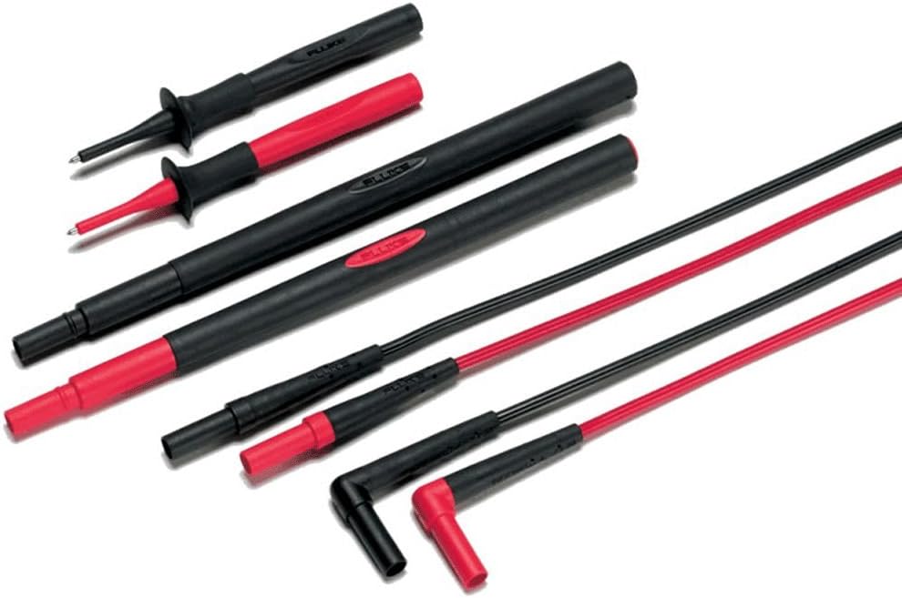

Well, I believe that Fluke leads are actually made by Pomona.
Fluke does make leads kits that are directly intended for automotive work:
TL82 adapters for proving plugs and sockets:
.https://www.fluke.com/en-us/product/accessories/automotive/fluke-tl82
TLK281 and TLK282 general automotive lead kits:
https://www.fluke.com/en-us/product/accessories/kits/fluke-tlk281
https://www.fluke.com/en-us/product/accessories/kits/fluke-tlk282
The TLK282 includes some pin adapters for sockets, but not everything that the TL82 set includes.

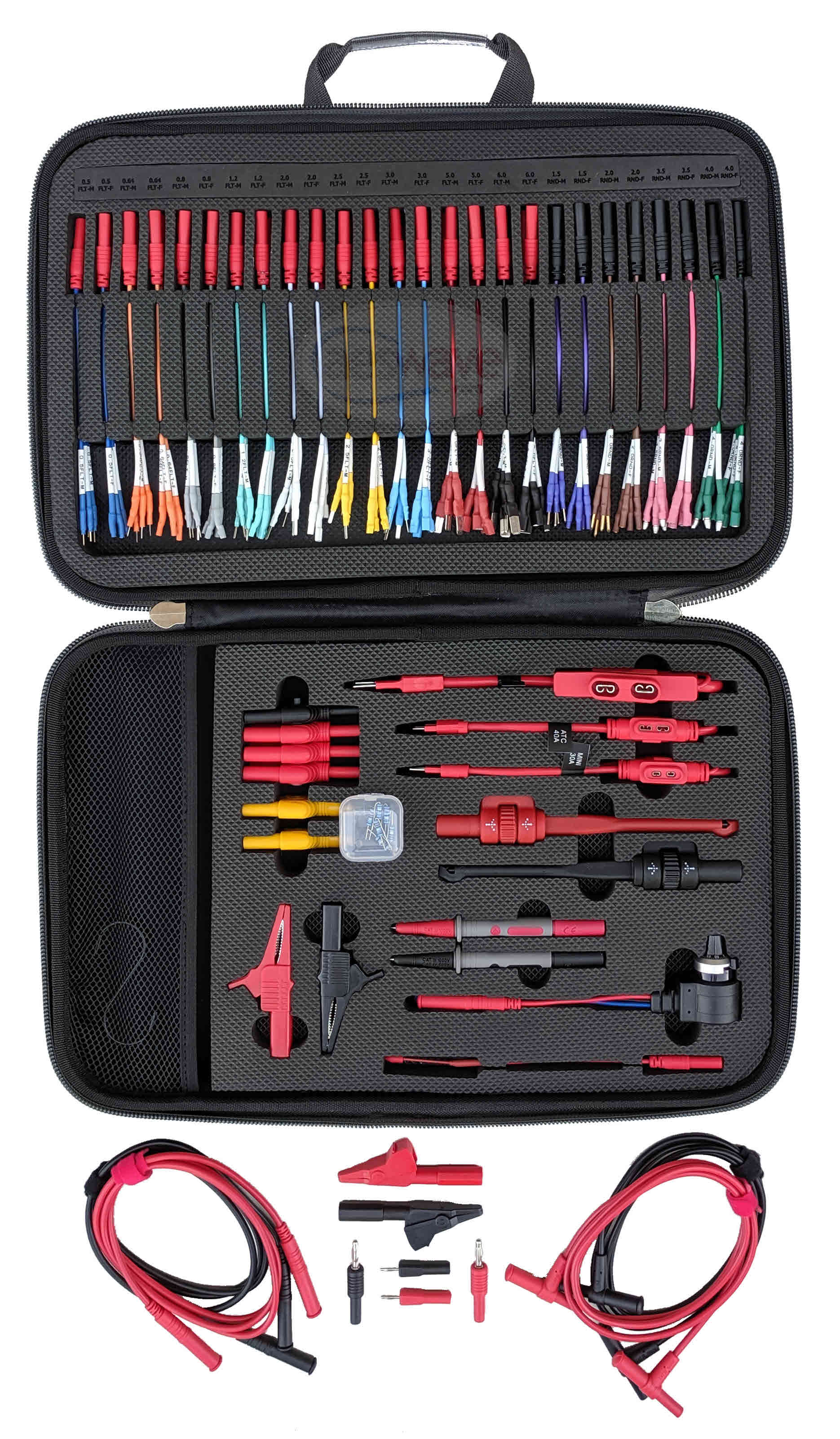

You can never have too many test leads. Start with a basic Fluke TL81A kit. After that add a Westward 1EKN6A 62 pc kit. Now get some of this style alligator clips. They penetrate insulation but the insulation heals itself after the clip is removed!! I'm not sure who makes them but they're a lifesaver.

Pomona 6530 - Amazon $137
Expensive but probably the best quality out there ! The Pomona wire piercing probes are fantastic. The screw down so they won't come off.
If you are putting together a kit, buy a Pomona 6252 Test Lead Coupler set or maybe even 2 to extend your leads or to grab battery positive and negative. The get 2 sets of 6' (or longer) patch cords. (I like the Pomona stackable patch cords)

I was looking at that set. Fluke has similar for $50 more but I don't know if they lock as you describe
