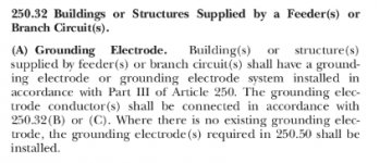

I spoke with the electrician this evening about the need for a ground at the new panel. He said it is not necessary since the ground is carried all the way from the new panel to the supply panel, where it’s properly grounded at that point.
He did advise against running the 12/3 to 2 separate circuits (MWBC) and sharing a neutral. He said that code changed about four years ago and with all of the LED lights and such that the potential for issues is higher.....If I heard him right. That being said I will carry-on with 12 two for each circuit.

mm08822
Jan 13, 2012
5,990
Just to be clear, we are talking about the grounding electrode system and grounding electrode conductor. Not the equipment grounding conductor.
He is wrong and needs to read NEC 250.32. i've attached the NEC article and an illustration for you.
pattenp
Jun 4, 2008
10,175
Virginia - USA
The grounding electrode system is to help divert lighting strikes to the earth if the strike occurs at the detached structure. You don't want that strike traveling on the equipment ground conductor back to the main panel if possible.

Makes complete sense, and thanks for the graphic....that’s helpful. What can I say, I hired a licensed professional, even questioned him on this subject months after, and here I am.
pattenp - you mentioned earlier I need (2) 8’ ground electrodes at my new building? Looking at my house and other detached shop they appear to only have 1 each?

NEC only requires one rod if resistance is 25 ohms or less to earth which requires expense to prove so it's more economical to just drive two rods to satisfy the resistance requirements.
Does the copper wire need to be in conduit where it enters the panel? I have a 90 degree 1.75” elbow under the base / skirt board and a short (25”) of 1.75” conduit run into my “electrical panel area”. Can the copper ground wire exit the conduit and then be stapled / secured the wood backing before entering a knock out.
I need to get a pic quick. The more I think about it, I should probably reduce the 1.75” down to something that can enter the panel “cleanly”.

The grounding electrode conductor does not have to be in conduit.
Thanks. I still may clean it up and move it over to the right, where a larger knockout exists. 85de8817003a5cbf37bf52e860daf48c.jpg7f8d3174f3d1db780807f0fb54dfcdb3.jpg0ef7dba27b15761345c81883b5755505.jpg
