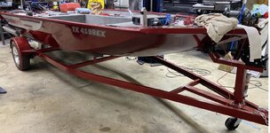

Things sure slow down when you get to the detail part! Making progress, though, I polished up the ‘glas steering console (not in this pic) , put some wires in, started in with the newest steering cable, a bit of progress made.

I’ve now run into a snag. With my awesome daughter stopping by to help, we carpeted all five of the storage bay lids which was a real pita as we were fully wrapping the carpet around the edges, just as the factory had done, clamping and gluing and.... then the doors won’t close!
Apparently the carpet I used is a silly millimeter thicker than what the factory used. On all three edges the carpet jams within the frames.
I am extremely upset about this and not sure the next move. What I did for now is trim all the edges so that the doors can close. They look awful when opened. They will rattle and fray, I cannot leave them like this.
I am truly bummed. The frames/doors/hinges are all fully welded; there’s no adjustment or fudge factor. There is 1/8” clearance on all sides. I have no idea what kind of carpet was on the doors originally as all the doors had lost most of it. The old carpet from the deck doesn’t appear any thinner than what I have. I’m thinking that maybe the original had astroturf on just the lids.
Now I have to do something as I hate this.
many ideas, anyone?
I’ve been thinking of Seadeck or rubber tread products to put on top, but that doesn’t fix the ugly bared edges of the doors OR fix the rattling.

About the only thing I can think of is to somehow remove the carpet from the storage bay lids and start over with thinner carpet. I fully realize the you, of course, have thought of this approach as well. As a former auto electric/electronic shop operator I know very well that removing new or old glued down carpet can be extremely difficult (worked with a number of carpeted sub-woofer speaker boxes).
The only time I was able to remove such carpet with fair success was by lifting an edge of the carpet followed by applying heat to the glue/carpet and box surface with a heat gun. Edit: There should be several adhesive removers (3M?) that might work or, at least help with the removal of any residual adhesive remaining on the lids if you are able to pull the carpet off.
Otherwise, you might consider talking this issue over with some marine upholstery repair shops or forums.

The doors are aluminum right? I would think about taking the carpet off completely and polishing the top and leaving it that way. Maybe put a coat of clear on it or even paint them like you did the hull? Then run some type of rubber gasket around the channel that it fits into to tighten up the fit and eliminate any rattles.

If you only need a mm of clearance can you shave down the thickness of the carpet by that amount? Take a few runs over it with some electric shears or something?

I had exactly that thought process last night, immediately AFTER I had trimmed all the edges out of frustration! I HAVE some great Andis grooming clippers and I bet that I COULD just shave the pile from the carpet. But now, I'll have to order and install it again, just to find out!
Yet another rash decision with a consequence...

Can you get some thin aluminum angle to go over the existing carpet and wrap around and cover the exposed edges of the door? I am making the assumption that the angle is thinner than the carpet.

I actually did a mock-up of that last night...couldn't get comfy with the look.

I THINK I have found what will serve as my solution; while cruising the boat dealers I noticed that a couple of G3 boats had an embossed sheet vinyl (supposedly non-skid) material over the deck. It was good looking, somewhat soft, and most of all *THIN*.
Some web research has me convinced that it is Marideck Marine Flooring (non-porous Solid PVC) as sold here: MARIDECK .
Available in 34 mil and 80 mil. I have ordered some samples.
I am banking on this stuff to save my day by using it to only cover the lids and let it make a (hopefully) pleasant contrast with the installed carpet. I also found it on Amazon but with a hefty minimum purchase. the link above appears to let you buy as little as one foot by six foot.
