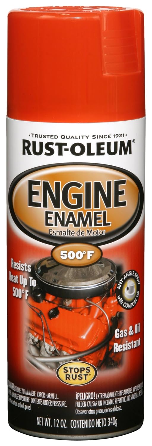

Used almost a full can of primer and another full can of paint.
Used this for Primer:
http://www.amazon.com/gp/product/B000V69Q58/ref=oh_details_o02_s00_i00?ie=UTF8&psc=1
And this for Paint:
http://www.amazon.com/gp/product/B003CT4AGG/ref=oh_details_o02_s00_i01?ie=UTF8&psc=1
Paint went up in price in the few weeks since I purchased it - was $6.83.
Still need to paint the casters, handle and some small parts. Hope to get to that tomorrow.
