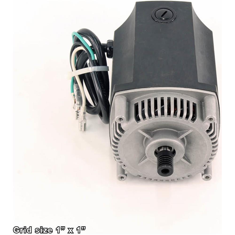

So I have had this jointer / planer for about ten years and I have loved it. All of the sudden while planing some wood I smelled something like plastic burning. Eventually I looked under the device and a little bit of smoke was coming out of the motor.
I dismantled it last night and still need to get the pulley off of it. The brushes I think are ok, but I am not sure about the inside of the motor. The motor cost $350 to replace it, so I hope it’s fixable!!!

Check out surplus center for a motor with the same frame size. No way would I pay $300 for that motor.

I would love to find a replacement motor. But to find one that matches the 1900rpm would be difficult.

1750 would be very easy. And likely close enough. Highly doubt it was ever 1900. What’s the hp rating? Could get a 3-phase and a vfd for probably >$300
no704
Apr 27, 2016
5,257
Measure the bolt pattern and stand off height and output shaft dimensions. I bet you can find one. Figure out what motor frame size it is. For a 110v motor I assume.
no704
Apr 27, 2016
5,257
I realize you just lost your baby. But you can do it! It will be easy to replace this. Just be sure to to get a continuous use motor. I’m sure there are plenty on amazon or eBay once you identify the Moter size. Lots of internet sites with that information available once you have a couple measurements.

Alternator/starter/motor repair shop would probably rebuild it for less than the cost of new and you'd be supporting a small business in the process.
This is not a starter or alternator. It's a small AC motor with severe damage. I suspect a motor repair shop would direct you to buy a new motor.
I would expect 2x to 3x the replacement cost, *if* you could find someone to rebuild it. Unless it's unavailable replacement is cheaper until you get into bigger sizes.

Take it into a good motor electric shop. They will tell you your options. They may be able to rewind it for you

When you buy a power tool that was built to a "Price Point", you eventually find out why the lower priced tool was cheaper.
On belt drive equipment, changing pulley sizes can often get you the speed you want.

@1Garageman I saw this reference - it may relate to your machine. Is it possible you have a 19,000 RPM motor, not 1900? I'm thinking this is similar to a router motor and the CUTTER HEAD is actually geared DOWN to 9000 RPM. Your motor certainly has a small pulley, so I doubt it's turning slowly.
Is the cutter head pulley about twice the diameter of the motor pulley?

That is about every lunch box planers demise i have seen, those universal motors are not designed for a long life like an induction motor
A lunch box planer is a portable tool. Having a motor that weighs almost as much as the rest of the machine would be a questionable engineering choice.
There are plenty of 40-50 year old portable table saws with universal motors just like this one working just fine to this day.
