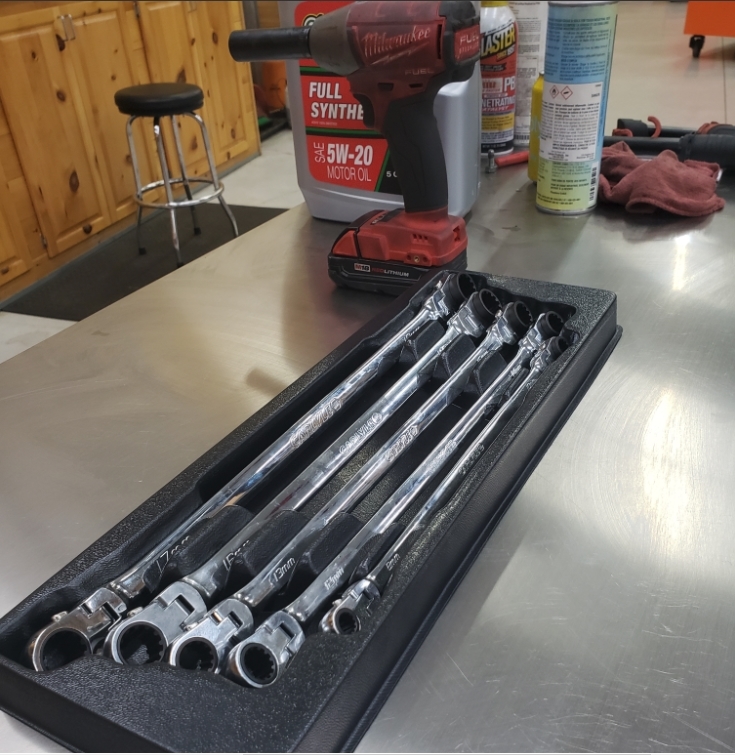

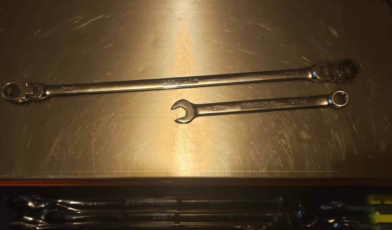

Here are pics of the 8/10 and the set in my home box. 83baaa78aaa7c8ee0bc3f63861762d3a.jpgb84c6cd7accecb6106ce3d8f459d5a2d.jpgb20c3716ea429feeb2f9b6dec4e38285.jpg
