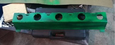

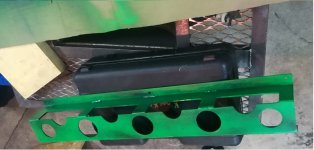

I really don't post much on here. I am always in my garage working on something, or making something...But, I don't think most of it is worth sharing. The other day I made a couple of organizers/ holders to help me keep my little shop from being so cluttered. The first is a grinder rack. I have a holder on each of my tables, but I always have grinders just laying around, and this gives me a place to put them. I did copy ZTFab's look, but the dimensions are mine. And the paint job... ya it was an experiment. fluorescent green and black splatter.:bounce:
Next, is a vise grip rack. I usually keep them in a drawer in my toolbox, but I always have to get them out, so I figured I would make an exposed holder for them. I found a similar idea on pinterest, but I modified it to work with material I had. The wall mount is a piece of 1"x1/8" angle. The part that holds the screw is 1" EMT conduit. I made the slot in the bottom just big enough for the stem to be able to slide easy without the head falling through. I did it the same way for the smaller clamps. I think it was 7/16" and 5/16" slots i cut.

I really like your racks especially the vise grip rack. I have been trying to come up with an idea to put on my welding cart. Thanks, Jim
Sent from my SM-A102U using Tapatalk
The idea I found on pinterest was using square tube. I thought about going that route, but when you cut square tube lengthwise, it splays(?) out. I think this way turned out great.

On the vise-grip rack, could you cut half rounds out of the bottom with a hole saw in a couple spots so you can pull out of the center of the rack if you needed to?
If you wanted to go that route, sure. I made these because it worked for me. your mileage may vary. Also, I made 3 of these racks so, I have similar types/sizes grouped together. If I run into that problem, then back to making more. :beer:
