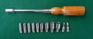

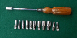

Siro Scurati & C. 12 piece Metric Socket Wrench Set in Original Box
manufactured by Siro Scurati & C., No. 33 Via A. Manzoni, Milan, Italy
this set contains:
4 mm 6-point socket
4.5 mm 6-point "
5 mm 6-point "
5.5 mm 6-point "
6 mm 6-point "
7 mm 6-point "
8 mm 6-point "
9 mm 6-point "
10 mm 6-point "
3 mm slotted screwdriver bit
5 mm slotted screwdriver bit
- Drive Handle
- The tools use a unique type of drive system. The sockets lock into the drive handle with a detent ball.
- These tools are not compatible for use with other standard drive systems.

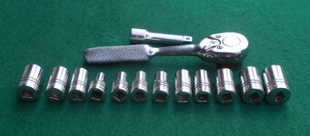

Firestone 13 piece 1/4" drive SAE Socket Wrench Set in Original Box
manufactured for the Firestone Tire & Rubber Co. by the Plomb Tool Company, Los Angeles, California
this set contains:
7/32" 6-point
1/4" 6-point
9/32" 6-point
5/16" 6-point
11/32" 6-point
3/8" 6-point
7/16" 6-point
- 6-inch extension
- 5-inch flex handle (breaker bar)
- 5/32" x 3-inch crossbar
- Oval-Head Ratchet
- Steel Box
- The set is complete per the illustration from the 1948 Firestone catalog (page 44)
- All of the pieces are marked "Firestone" and "USA" with the exception of the unmarked cross bar.
- There are no part numbers on any of the pieces.

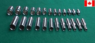

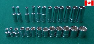

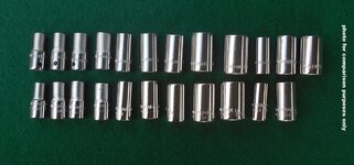

29,700
HERBRAND 25 piece 1/4" drive 6-point METRIC Socket Wrench Set with Holders (sockets only)
manufactured for the Herbrand Company, by Seco Tools of Toronto, Ontario, Canada
this set contains:
standard shallow sockets:
MM604 4mm 6-point marked Herbrand
MM605 5mm 6-point "
MM605 6mm 6-point "
MM607 7mm 6-point "
MM608 8mm 6-point "
MM609 9mm 6-point "
MM610 10mm 6-point "
MM611 11mm 6-point "
MM612 12mm 6-point "
MM613 13mm 6-point "
MM614 14mm 6-point "
MM615 15mm 6-point "
MM616 16mm 6-point "
deep-well sockets:
MM804 4mm 6-point marked Herbrand
MM804.5 4.5mm 6-point "
MM805 5mm 6-point "
MM805.5 5.5mm 6-point "
MM806 6mm 6-point "
MM808 7mm 6-point marked Herbrand CANADA
MM808 8mm 6-point marked Herbrand
MM809 9mm 6-point marked Herbrand CANADA
MM810 10mm 6-point marked Herbrand
MM811 11mm 6-point "
MM812 12mm 6-point "
MM813 13mm 6-point "
Herbrand / Herbrand Co., 109-25 E. State St., Fremont, OH (1881-1961) / Orangeburg, SC (1962-1967) (Kelsey-Hayes) / 1967-? Triangle Corp. / Triangle acquired by Cooper Industries 1993 / "Vi-Chrome" / http://www.yesterdaystractors.com/cgi-bin/viewit.cgi?bd=toolt&th=4960 / http://alloy-artifacts.org/herbrand-van-chrome.html / http://alloy-artifacts.org/herbrand-van-chrome.html#history / https://www.garagejournal.com/forum/threads/lets-see-your-herbrand.390421/ /
Seco / Seco Tool Co., 340 Dufferin St., Toronto, Ontario, Canada / contract supplier for several U.S. based tool companies / http://progress-is-fine.blogspot.com/2013/04/we-used-to-make-things-in-this-country_13.html /
see also:
https://www.garagejournal.com/forum...nney-affliction.273680/page-134#post-10435136
and the following three or four posts
