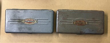

I went through and made sure some of my early Craftsman 1/4”drive sets were accurate and complete. A couple of them were picked up over the summer. I posted some on another thread as well.

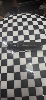

^ that's an odd driver handle there, Don.... where'd that come from? :unsure:

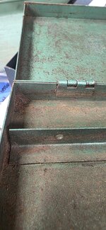

Help. I picked up this Duro box off ebay. It says 5605 but the catalogs on ITCL show 5605 as a 25 piece 1/4 drive set. Perhaps just mislabled but the number looks like part of the sticker. This box appears as a 3/8 drive set. I've snapped a pic with 3/8" drive sockets in it. 1000019927.jpgAnybody have any ideas? The box measures at 11" x 4"1000019925.jpg1000019923.jpg
F
29,646
^ Off the top of my head, I'd say "3/8" drive box" - the only long 1/4" drive box we know of that Duro made was that dark khaki green WWII vintage model.
Don knows Duro-Chrome much better than I do.

I don’t understand why the slot is so wide if the correct label is on the box. They did offer some 3/8” drive sets but the part numbers are different. IMG_8906.jpeg
30,914
It says 5605
FWIW, I have never seen a set number hand-scrawled like that before. Don owns and has seen more sets than me, and he may know better, but the set numbers on mine and those I have seen are stamped or machine printed there. That may mean absolutely nothing.
EDIT: One caveat to that is that the style of your label is later than any sets I collect. It matches the labels in the 1962 catalog.
The only other thing that might be worth trying to track down is the other part number that is printed on the label: "DU-L87". I have no idea what it signifies. The "DU" seems to be a prefix for an internal DUro-Chrome part numbering system. The "L" may be Large. I do see part numbers for boxes only with an "87" in them, which also might mean nothing.
30,914
Didn't you say it's a 25-piece kit?
The box for the 25-pc kit with that set number shows a provision for six (6) deep sockets in the main compartment. And the socket tray as depicted is narrow/tight and wouldn't dwarf 1/4-inch drive sockets, which would rattle around loose in a tray that wide and tapering out even wider. I think that's the source of the quandary.

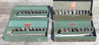

I took a look at my much earlier refrigeration set and it has a wide socket groove and some 3/8” drive sockets. I suppose there is a possibility that the box could have held one of those. IMG_8909.jpeg

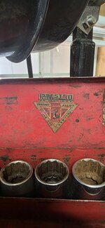

Hmm. With Don reminding me of the reefer sets, I have to take back what I said in reply to @Beerhippie about the 1/4-inch drive sockets being dwarfed and rattling around loose in that oversized tray. All of that is still obviously true, but that didn't deter Duro from putting their 1/4-inch drive reefer sets in boxes that - now that I think about it further, sure do seem to be designed for 3/8-inch drive sockets. As can be seen in the photos of my ca. 1951 No. 4518-RS set below posted years ago on the DI thread. It's not as evident when the sockets are out of the box, but it's quite evident when they're loaded.
I'm not saying, per se, that @Tom "Python" Aycock 's box is a mislabeled reefer set. But if they had a propensity for putting large (qty of pcs) 1/4-inch drive reefer sets in boxes that seemed designed for 3/8-inch drive sets, it follows that they may have done it at times for large (qty of pcs) regular 1/4-inch drive sets. That doesn't explain the hand-scrawled, partially mangled number, but there are other explanations for that (supply of stamped decals ran out, expedience, etc).
