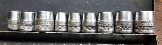

Months and months ago, I bought one of those Klein fingertip mini-ratchet drivers with its assorted bits (#65200). Soon I realized that with the 1/4" driver in the set, I should gather a collection of 1/4" drive sockets to keep with the ratchet. It would be stored upstairs in the quick-access tool drawer in the utility room. (This was to be separate from the standard 1/4" drive socket set I have from Craftsman, which lives in its own box in the workshop.)
To put some limits on the collection, I decided it had to fit wholly within a metal box that a Boker folding knife came in — Altoids tins are too small — so the set would run from 1/8" to 1/2" by 32nds. (Possible future addition would be the omitted 1/64" sockets. We'll see if this happens.)
Being a tool collector, the guiding rule in assembling the set was that they had to be found in the big bin of sockets at the local ReStore shop, which had maybe 300 sockets (all sizes & drives) dumped in there. No fair buying new — too easy.
Anyway, the photos show the set (bits, ratchet, sockets, and a P0 Craftsman screwdriver) in the box and all the sockets lined up. Three of the sizes have duplicates. (The three in front are a E5, a 4mm and a 4.5mm.)
The collection currently runs: 1/8, 5/32, 3/16, 7/32, 9/32 (have 2), 5/16 (2), 11/32 (2), 3/8, 13/32, 7/16, 15/32, 1/2, 9/16.
The 9/16 is outside the limit, but it's in good shape and it fits in the box, so why not?
If you're tempted to do a similar dumpster dive for sockets in a big bin, bring cheater eyeglasses and patience. You'll need both. (Also some hand cleaner.)
