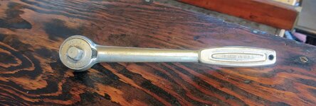

I need help from all our Craftsman buffs. Does anyone know the story behind this 1/2 ratchet? The mechanism can be removed with no tools by pressing in on the quick release harder than normal. Interesting ratchet, but kinda "gimmicki" at the same time. I don't think this ever caught on (as it's marked PAT. PEND). I saw a guy on YouTube that said it was only offered in the 1988 Sears catalog & it was the most expensive ratchet offered. I'd be a little shocked if that was true. Does anyone know anything about this one, or how long it was offered??

Ben, that looks like a Craftsman Quik-Clean ratchet. Just like the name sounds - made for quick and easy cleaning and lube. I don't think it lasted too long in production.

Thanks. I think I heard mentioned Quik-Clean before. The other question is was it USA made?
