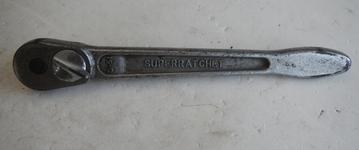

Here is a 676D plug ratchet I recently bought. No markings on the handle itself. Duro Chrome on the face with 676D, both hard to read since they are underneath the lever.
Since this is a reversing plug ratchet, it is hard to read and the stud for the lever does not go all of the way through to the back cover is this a transition model or possibly just using up leftover stock?
29,837
Debcrow said:
"...it is hard to read and the stud for the lever does not go all of the way through to the back cover..."
Not sure what part is "hard to read" - it's stamped with the manufacturer's name, part number, and patent number, which is about all any of them were stamped with (if that much.)
By "stud for the lever" you are referring to the pin on which the selector lever pivots, it's peened on the backside of the cover plate, so it would not "go all of the way through."
There was no "transition". There were three variants of the original 3202 made: the first had a 16-tooth mechanism (made up until... 1936? 1938?) second had 18 teeth (to 1938?) and the third was a 36-tooth mechanism (1938 on.) (I had that figured out and posted it in the "Duro Ratchet?" thread I cited above.)
The 3202R (and its Duro-Chrome equivalent 676D - your model above) appears in the 1937 catalog (and subsequent issues through 1959), but other than tooth count there weren't any design changes made on it.
Debcrow
May 14, 2019
4,151
New Mexico
Thanks for the information, great to know the years of manufacture.
I realize there are slight design changes through the years and that there is difference between Indestro and Duro-Chrome.
Most of the levers I see on the internet have a different inscribed lines on them and the lever shafts are 4 sided instead of 6 sided so it is a little confusing trying to compare models/years.
The HARD TO READ is the model number which is directly under the lever.
I am familiar with Duro Chrome and Indestro so I knew what brand it was even if it is partially covered at all times.
I had to get a bright light and an eye loupe to read the last 6 since it is pretty much covered at all times and the lever is just barely above it. Even then I was not sure if it was a 6 or an 8 and guessed at 6.
The seven is also always partly covered, but the figure 7 is pretty unique so it was not hard to figure out.

The two of these on left are 16 toothers, the 3rd 18 and a mid 50s 36 toothed on right. The far left one came in an early 30s set and lacks that little bump in handle at base of ratchet head

I am assuming you are talking about the patent number, 1902878, which is the same patent number applicable on all of those models: 3201, 3202, 3202-R, 2788, 2789, 2889... as well as a few others.
The 1902878 patent, and the "pressed flange" ratchet design to which is applies, was the subject of the other Duro Ratchet Thread I cited above, where more photo images can be found.

4.c., @Debcrow is talking about the model number. Are you looking at the photo? The model number is obscured by the direction switch.
@Debcrow - they made so many variants of their ratchets, but if you scroll through this thread alone, or the DI thread, you'll see that on some the model number is on the other face plate, not under the switch.
29,837
^ No... I didn't even focus on that for the reason you just mentioned above - they're stamped on both sides, and some are stamped only with the patent number, or only the model number, or (in some cases) only "Chicago".
If you peruse through that other "Duro Ratchet?" thread it becomes clearly evident there was no consistency or pattern at all in respect to how they were marked, or what was marked on them.

I am one of those who tend to ID things by identical markings in identical patterns to try and date things.
Knowing that the "consistency" in markings for Indestro & Duro-Chrome is that there seems to be "NO CONSISTANCY" of pattern is actually quite helpful. I will tend to be more observant of other things such as shapes, model numbers and other variations for these tools to help identify specifics.
THANKS again.
29,837
^ The only major changes that are constants on the 3202 and 3202-R are tooth counts: the 16-tooth mechanism (exclusive to the 3202) only lasted a few years, and was replaced with an 18-tooth mechanism. They both later went to the 36-tooth mechanism.
The other changes/differences that have been noted here - the little "bump" under the head in OTG's example above, or the "4-sided/6-sided" variants on selector lever shafts - are news to me, and I have no idea if they have any relevance or might be of any use in attempting to definitively establish date range.
Candidly, my best guess is that Indestro was cranking these out as fast as they could for their own distributors as well as their many private-label accounts, and superfluous matters such as which side the part number was stamped on simply weren't a priority.

I picked up a couple of good ratchets yesterday. The infamous "Superratchet" by J.H. Williams & an unmarked Indestro with it's original plug. Looks like the Indestro only came in a chromium vanadium set for 3 yrs ('35-'37). I needed this one to help complete my family of early Indestro Duro rats. The Superratchet is nice & beefy. This is the earlier version, but according to AA there is an even earlier variant that was stamped just Superratchet instead of "The Superratchet." AA says these are the earlier ones and are somewhat rare. So, I looked online & found one for sale only marked Superratchet. I should get it next week. I'll throw up side by side pics once I get it. Everyone check your Williams Superratchet & see if you have the more rare variant marked Superratchet instead of "The Superratchet."

As promised, here are my Superratchets side by side. One is stamped "The Superratchet" and the earlier one just stamped Superratchet. AA claims the one just marked Superratchet is rare...who knows. I also noticed on the one marked "The Superratchet" below the words Drop Forged is forged dot in the steel & the older one doesn't have this. That is the only other difference I noticed which I'm not sure what it is.
