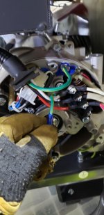

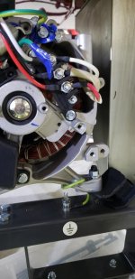

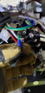

Hello, I followed this thread as I have a B&S 8000 watt Generator with a bonded ground.
I opened the cover and disconnected the small green/yellow Jumper but the gfci still flips whenever I hook it to my panel. I am going through a 30 amp twist lock cord attached to the exterior of the house and into a breaker. a L14 r/p to the panel with an interlock.
There also is a ground wire on the frame.. i undid that too and same result.
Not sure what to try next. There is another green/yellow wire there as well that hooks to the frame and comes from the outlet panel on the generator itself.
The blue tape on the end of the wire is so I can reconnect it if I want to. I also put a bit of blue tape on the screw that I took it off from. One picture has the ground to the frame at the bottom.
Any suggestions?

The yellow/grn wire is the chassis ground. You DONT want to disconnect that. If you do, and something shorts the frame, the breaker wont trip and then you have fault current on anything that is metal.
The GFCI is tripping because you have a neutral to grnd bond somewhere along the line.
Can you post a pic of your panel with the covers removed.

I thought this after I posted here... That the panel is also grounded to the frame. That would be the other green yellow striped wire that is there. The problem is that the whole panel is GFCI protected I am going to use the 30 amp twist 240v connection, but if i remember correctly, the ground (green yellow stripe) connects them all.
I will go take it out and snap a pic. be back shortly and post it.
Thanks.
