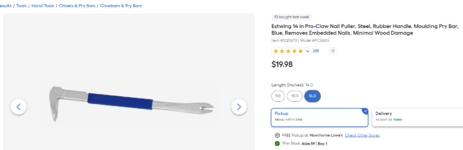

I use a cat's paw, pretty much the same tool that DigDoug linked to above. By far it's the best tool to get to a nail head that's flush or recessed in lumber.
That and a Estwing all-steel framing hammer. Great hammer for demo work.
I'll use the hammer to pound the cat's paw under the nail head. Pry it up. If the nail is long and I need more leverage, to pull it out of the wood I use the hammer's head underneath the cat's paw for added leverage.
Been using the cat's paw for over 50 years. Haven't found anything as versatile for a wide range of nails sunk in a wide variety of wood. When I was a kid a side job was breaking down pallets and crates used when shipping machinery.
A flat prybar can sometimes be a good companion tool. Hammer the prybar between two boards, pry it up just a bit, pound the top board back down to expose the nail heads. Or if they separate easily, pry the board off completely, then the nails from behind to drive them out backwards to expose the heads, then pull them.

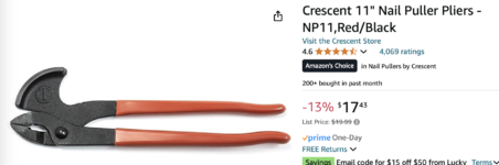

I have some nails that do not have a pointed end that sticks out; they have to be removed via crowbar. Looks like a gooseneck one that is longer than the 12" one I currently have is in order? Is a flat bar better?
Flat bars are popular for several reasons, but nail pulling is not their strong point. Being wide, they're better for removing trim without damaging, and can be used to lift a door during hinge installation, or space deck boards. It's more of an all-around tool.
The pneumatic denailer is a huge time saver when you have access to the points and some shank, but when pulling by the head you have a few options, depending on how much you're willing to damage wood around an embedded head.
A cat's paw can be hammered under a nail head. The chrome plated Esting with the rubber grip version is better for smaller nails, and their mini one is amazing on staples. I use these to lift the head just enough to then pull the nail with a bigger bar with a wider knuckle to roll on. My favorite is the Estwing I-Beam bar, but an 18" bar can be hard on the elbows with bigger or rustier nails, so I have a 24" backup. Especially on the cat's paw, don't be afraid to sharpen the tips a bit with a file. It can make a big difference in making it easier to get the bar into place.
Sliding nail pullers are the only type of puller that can effectively pull a nail by the shank. When you're managed to rip the head off already, they're a lifesaver:

I have and use an Estwing cats paw as above, works better for smaller nails, its intended to drive in under the head of the nail, and pry it out the first inch or so. Mine is still sharp enough to catch the shank of a nail when the head has popped off.

I'll use flat bars, the Crescent nail puller I got at a garage sale, or ear clamp pliers for nail pulling. The ear clamp pliers are great if the head has come off.
