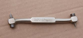

Hello tymbo,
I had the same tool or one that was nearly identical to your photo but can't find it now. Would you reply with the manufacturer and tool no of this nailset? I tried blowing-up the photo but still can't make out the tool number or manufacturer details, too fuzzy.
Thanks.
Mike
13,365
Hello tymbo,
Thanks.
Mike
Millers Falls 233 on my phone.
