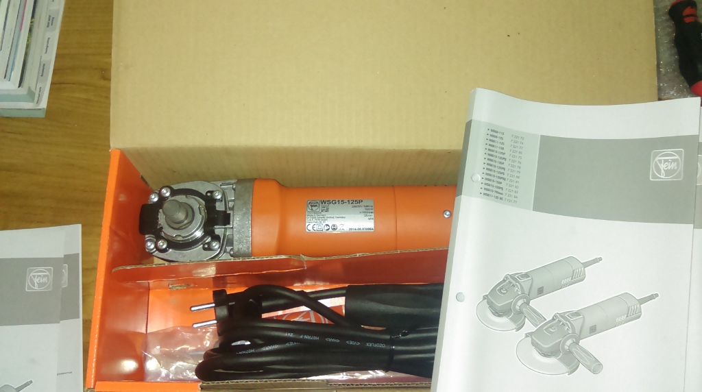

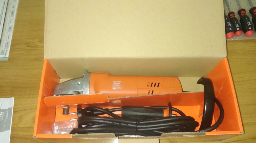

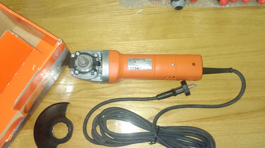

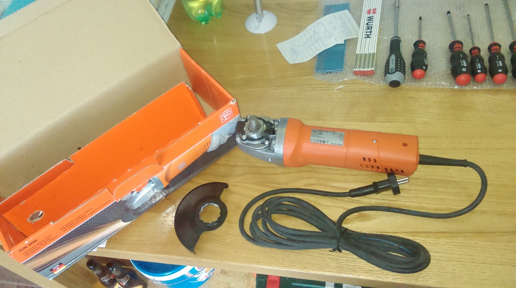

Posted this in new tool arrivals too. Came today W9-115
View media item 50762
You're gonna love it. I ended up buying 4 or 5 Metabos in the last 2 years.
I've said it before on here, but I really like having the small Makitas as well for more detailed work that requires one-handed use. The Metabos are bigger and heavier, which is fine, but they both have their place. I also have Milwaukee and DeWalt. Combo of Germany, Japan, USA, and one Milwaukee China.
