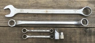

Here are some Challenger marked wrenches followed by some Challlenger by Proto wrenches. Just to muddy the waters a bit the last picture is of some Tru-test wrenches.

These are marked challenger on one side and mfd. Penens on the other.

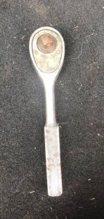

Found this ratchet at a garage sale today for the equivalent of about $0.30 (when extrapolated with a hand-picked box of about 50 items for $15.) Interested to learn that its part of the Plomb/Proto heritage. The interesting thing to me is that they probably spent more money trying to make it a little different (Notice selector isn't recessed) than it could have been worth, especially to sell for a lower cost.

Oldtuleguy
Nov 4, 2017
10,457
They made a bunch of those ratchets and sold them under different names, even supplied them to wards and firestone.
