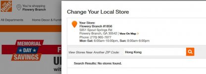

Cobra5150
Feb 2, 2008
1,976
GA
Here home depot rents a large towable mixer for almost $100 a day. A yard of concrete is roughly that pricedelivered.
Long way to tow a towable
