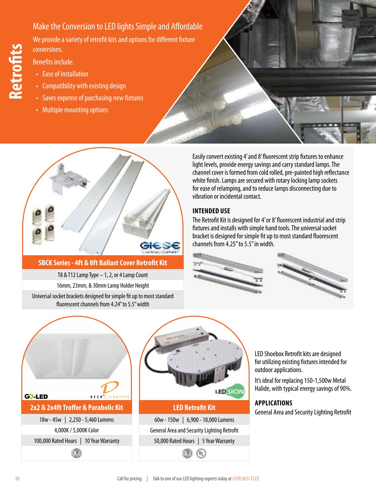

Where can you get the conversion kit for $13? I get a universal style that fits all the different widths of fixtures and they come with eight tombstones, new fixture covers, 16 gauge wire, adjustable saddles that accommodate different widths of fixtures, the mounting screws, and a Wago style disconnect. I also spend a little more for the tubes that can be connected single ended, double ended, or work with an electronic ballast. That way, I only keep one style of lamp on hand but in both 40 and 50K.
The tubes are on page 4 and the retro kits are on page 30 of the catalog

That would work, but the lack of a ballast cover might be a deal breaker. The 8' fixtures that have an 8' long cover would be a real PITA and have to be cut as well as holes drilled for the locking clips. And since the fixtures in this thread are the HO type, the fact that the cover is also the curved reflector would make it 10X worse. The fixtures with two 4' covers wouldn't be as bad, but the holes for the locking clips are probably in the wrong spot and the cover might have to be cut on them as well since the thickness of the tombstones wasn't planned for in the original design. Maybe the cover is part of the kit and isn't shown?
^^^ This. For all those reasons is why I suggested the Techbrite above.

There isn't a cover in the kit and didn't expect so for only $13. My fixtures have 2 piece covers and are regular square and no curved reflector. Any metal fab work is no issue for me. It's the kind of stuff I do alot.

There isn't a cover in the kit and didn't expect so for only $13. My fixtures have 2 piece covers. Any metal fab work is no issue for me. It's the kind of stuff I do alot.
It wouldn't be a real bad thing for someone that has metal working ability to do at home, but to do it for a job at the savings of $20ish each? Especially at the risk of a bad cut or hole drilled a little off, no thanks. If it were just a couple, I'd give it a shot in my own shop.
