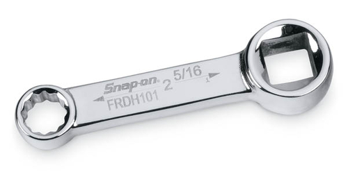

I need to torque the bull gear assembly in the front of my Detroit engine. The issue is that I don't have a torque wrench that goes that high. My torque wrench goes to 600 lb ft. I need to torque this nut to 750 lb ft in a counter clockwise method.
So other then a very expensive torque multiplier how else can I achieve this? I was thinking that maybe I could do a torque angle method, like maybe go to 600 and then turn it like half a turn or something.
Suggestions?? I'm doing this today so need input asap.
Also a local tool dealer has the socket in stock but I have to use a reducer to bring it down to 3/4" drive, the dealer says that won't affect my torque but my experience is that it will....thoughts??

You need an extension arm.
When the arm extends perpendicular to the torque wrench, there is no change in torque value. When it is in the same direction, it alters the torque value according to this formula.
https://www.engineersedge.com/manufacturing_spec/calculator/torque_adapter_extension.htm

Zewnten
Jun 11, 2017
1,865
We use a torque multiplyer with a half inch torque wrench. Ours is 4 to 1 so we set the wrench at a quarter of what it calls for. Might be a shop around you willing to rent theirs to you

Borrowed this from my landscape guy. He works for caterpillar. It's 18:1 ratio. What a breeze. My cdi wrench is bi-****** hahaha. Torques both way so that saved me. It's currently torqued to 756 lbs. I took it to 600 with my wrench and the rest with the multiplier. I have to check the drag on the bearings with a fish scale tomorrow so I gotta pull the assembly out. And just as I hoped. The nut is damn new in the same location!!
