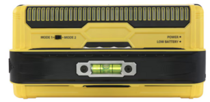

My 30 year old zircon never seemed all that robust and I want something modern for a small job. Wire detection a plus.
Thinking of the "Pro" HF model on sale, wondering what else is out there.
Would not mind the "walbot" type models, but not interested in spending $150 and up

The Franklin M150 (as noted above, it's at Harbor Freight somehow) is the first and only stud finder I've used that, actually, y'know, works.
I'm not a fan of scratching around with magnets; the framing is so wonky in my house that finding a screw or nail doesn't necessarily mean that it's in a stud, or that the next one is 16" away.

i recently used a franklin prosensor max FSMAX12
it's the best normal stud finder i've used. i played around with it on a normal wall, and it worked great. the wide scan area and display is luxurious. at $120, this is their most expensive scanner i think. it has 13 sensors, but they also have cheaper ones with 13 as well... i'm not sure what the difference is. never used them.
downside is it doesn't have modes specifically for detecting metal or AC, but that's always spotty anyway. still, because of that, it's handy to have a zircon or similar with those features. the above franklin will pick up metal conduit as a stud in my testing. i'd use the franklin first and then some otherwise shittier scanner to try to distinguish metal from wood. a magnet doesn't quite cut it unless you have an insanely strong one, but i guess you could use a magnet the normal way to look for the presence/absence of nails. if there's no nails, it might not be a stud.

I got the Franklin M150, thought it walked off and decided to get the M210, then found my M150.
Having alternated between them, the M150 is good, the M210 is great. Could recommend either, but would send the M150 back if I could.

I bought the Franklin at HF. Testing it in my house, it worked great on sheetrock walls, and failed completely on plaster. Since half of my house is plaster, and that’s where I needed to locate the studs, I took it back.
I’ve previously tried Zircon and others, with similar results. Plaster over rock lath is pretty close to impenetrable for these things.
