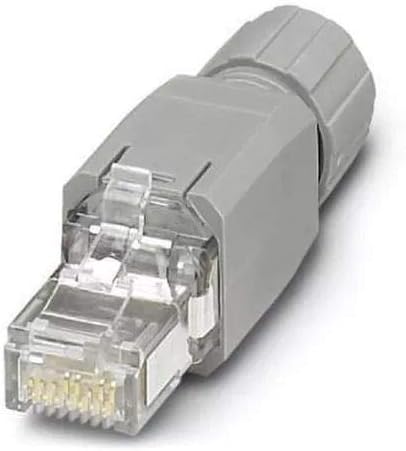

I build industrial control panels and install them. Most everything I build is controlled with ethernet and I run a lot. We use some really nice but expensive connectors, a lot easier to use than the cheap plastic **** ends sold at the big box store.
If I have to pull a pull string through a piece of conduit I use a piece of foam, tie the pull line in middle, stuff it conduit and use my shop vac to **** it out the other end. That's works pretty good. You can buy foam plugs but a scrap piece of foam is cheaper.
