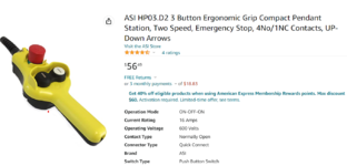

mm08822
Jan 13, 2012
6,266
This one will work....you need the 4 NO contacts and has 16a rated contacts. The description is wrong, it is only one speed (copy paste error).
The e-stop is not needed but it's easy to wire in to the circuit.
murchies
Jan 16, 2023
14
O thank you
