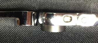

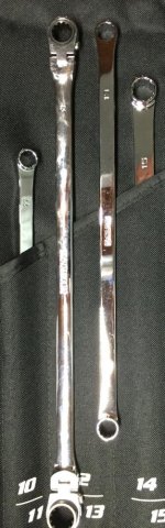

Here are a few shots of these Capri wrenches compared to the Mountain long pattern ratcheting wrenches (also sold under various brands like EZ Red, Platinum, etc.). The business end is 13mm, a size I use often. The Mountain is 13-15mm and the Capri is 12-13mm. The difference in length is about 3”. The mountain is a little under 16”, the Capri is 13” and a Stahlwille series 14 is 7.5” for comparison. The extra length (mountain vs. Capri) isn’t meaningful to me since should be able to get more than enough leverage on either. The business end is about 30% thinner and the outer diameter is probably 1/8” thinner or slightly more. The Capri outer diameter is a hair smaller than the black ratcheting insert in the mountain wrench. The Capri outer diameter is roughly the same as my other standard non ratcheting wrenches.
RKA
Jun 9, 2010
1,745
These look like the Genius as said. Genius skips 11mm and duplicates a few sizes; no issue for me. Both are machined out of bar or plate, not forged. Also fine. The only issue is the beam edges are not rounded- not comfortable to use, unless maybe you're wearing leather gloves. The Genius have held up perfectly, no issues, so these should be the same.

Ok, just to add a little clarity, the edges of the Capri wrenches are all eased. My best approximation is anywhere from 1/32” radius to as little as 1/64” radius. It varies depending on which wrench you pick up. Looking at the reviews on the genius wrenches, 1 out of 5 one star reviews were about the sharp profiles, the rest were on the flexible nature of the wrenches. Out of the remaining 55+ positive reviews, about 3 talked about the sharp profiles, the most recent being 2016.
Thank you. Overall thoughts on them?
RKA
Jun 9, 2010
1,745
Unfortunately it may be a while before I put them to use. The next 60F weekend may be a few months off and I'm only a DIYer, so it's not like I'll use them daily.
