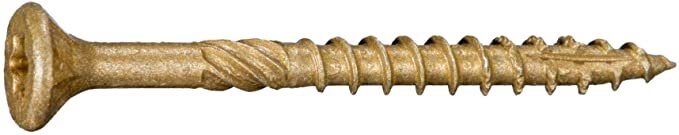

I've been using these GRK screws. I've driven millions of screws in my career, but these have that little spiral clearance cutter right where you'd want to hold the screw while starting it. It just ate the skin off my finger the first day. Even ate the tape off. Had to order one of these screw guides. Never used one before, but it works pretty well. Gets the screw started, then I pull back the collar so I can see the depth I want the screw set at, or else it drives way too deep. Gonna order a back-up.

I have used that screw guide before. I didn’t like it very much. My sheet metal screws are 5/16 hex heads and are very stable in my magnetic bit. I use Mechanix Wear gloves all the time anymore. It saves the wear and tear on my fingers and hands without giving up dexterity.
