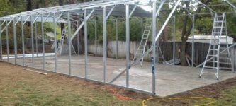

We moved over the border from Spokane to a newer home in Coeur d'Alene Idaho last Fall. It has a 2 car attached garage but no shop to work on the bikes and store their trailers and all the collective accessories. So I spent the summer putting in the slab and racing to finish the 20x30x11 building before Winter sets in. I am closed up but needing to get the heat & electrical in yet. I have the power run underground and the panel in so we have some power inside. Running PVC and #12 solid singles for the circuits. I had no shade in the back yard to wash & wax the machines so we put a 16' in front of the shop.
I left the boards out of the fence on purpose so my neighbor can come over and visit. He rides too so we are good neighbors and plan to put in a gate for him to use.
Starting over...

MrQ: i love a stick built garage especially when the sticks are steel. only thing i can see so far that i might be concerned about or change is the ground level on the side or maybe sides is right at the level of your pad. can you drop the dirt level a few inches so you don't have to worry about the steel plate getting rusty? or is there no possibility that water will ever crawl into your garage and on you cement?
nice looking with the covered carport area in front too. again welcome to our forum and happy to have you.

Looking good. How much did that building set you back?
The concrete work and permits were 10.5k and the building was another 10k delivered and setup! They took a day and a half to put up the building after 2 weeks of waiting for the concrete to cure.

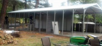

Thank you for your comments. The building actually sits on the edge of the concrete and the steel siding extends down 4 inches past the slab. I plan to pull the dirt back and replace it with gravel eventually so that the roof run off doesn't splash dirt all over the sides... maybe gutters with a dry well at the corner too.

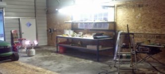

Doing the inside work now... I ran 12awg solid in PVC conduit for all wall circuits on 20amp breakers - each quad box has 2 separate circuits, top and bottom. All circuits are in PVC conduit for the lights as well. I wired the florescent lights separately with each side on it's own switch and the center tube on both together. So I can run just the center tubes on both for minimal lighting or just the outer tubes on either side. All lights makes it daylight at midnight in there! Now to get the gas to the shop for the overhead radiant heat... and paint this spring!

I'm not usually one for new builds, I really like the looks of your shop. I agree with Sunbimmer in that the carport really adds to the look. I also like the big window on the side. I'm looking forward to seeing how you finish the inside.
