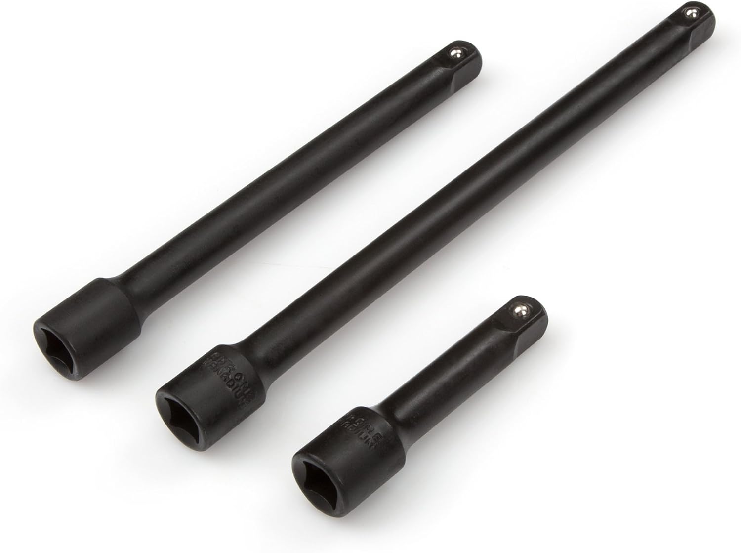

TEKTON 4966 3/8-Inch Drive Impact Extension Bar Set, Cr-V, 3-Piece
$10.49

Does anyone have the TEKTON 4966 3/8-Inch Drive Impact Extension Bar Set? How do they hold up?

3. What is a good brand for 3/8 impact extentions?
TEKTON 3/8-Inch Drive Deep Impact Socket Set, Metric, Cr-V, 6-Point, 7 mm - 19 mm, 13-
$25.45
The 13pc Deep Metric Sunex set is Cro-Mo construction and is only like a $1.00 more than Tecton CRV set/
https://www.amazon.com/dp/B0002SR9BI/?tag=atomicindus08-20
To be honest I have HF Pittsburgh impact extensions in 3/8 drive and I have no issues with them, really like the various sizes especially the short one, only $8.00 and can get 20% off too
https://www.harborfreight.com/38-in-drive-impact-extension-set-4-pc-67926.html
