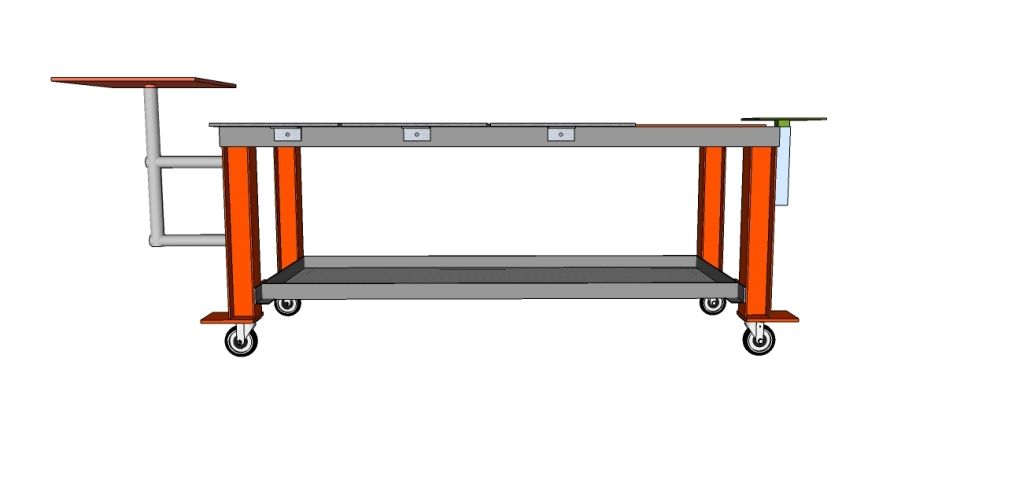

HI guys, I would like to share too my Heavy Duty Welding & cutting work bench basic design, I have started working on it though there will be some changes as I go along the process of fabricating this workbench. I have so many things still to add on its build. Maybe I'll post some pics as I progress. If that would be fine!!
Well all the materials I'll be putting in are sourced from scrap yards except of course the heavy duty wheel casters.
roberts56
Feb 26, 2012
15
Metro Manila, PHILIPPINES
@Hey jhn9840,
OK I have attached two small tables on the left side and on the right side.I'll start with the smaller green one first, it will be for a removable table vise plate, and I will have another one too for a metal bender that I will be fabricating also as soon as I finish this welding table.
The other table on the left which is color orange is for my detachable DIY welding positioner, which can be tilted, rotated and adjusted to a desired height for practice of over head welding. So that's how these small tables or plates will be utilized during fabs.
By the way, thanks for liking this heavy duty welding table design, this is only the basic design and as I go along the fab process I will be adding more features that will make project fabs easier in terms of movement and easy reach of metalworking tools. ;)
Glad you liked it and hope others too. :D
