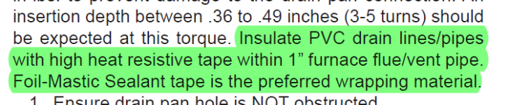

Regarding yes or no for the condensate drain, I encourage you to read the manual that came with it and follow it.
My read of the manual (from googling your specific model number) is that it shows the need to have a pee trap on the primary drain and the manual does not distinguish between positive pressure or negative pressure on the coil. (With positive pressure and no trap, you are blowing air down the drain line vs directing it to the conditioned space.)
Interestingly, I did see this tidbit regarding insulating the condensate line as alluded to by your friend. I have never seen this done in the field.
You will need to make a decision regarding how to address your secondary drain.
All of the furnace/AC systems installed in our units are vertical upflow units like yours with positive pressure at the coil and drain ports. They are all plumbed like the picture I posted. We have used Goodman, Rheem, Carrier, and now Lennox over the years and they all are plumbed like this. Our vertical upflow units are in the basement like yours.
Years ago, we would have a drain on the overflow pan but this was deleted and the float switch added. The pan drain would allow the unit to continue to run and not alert you to a problem. Deleting the drain lets the pan fill and the switch shuts the unit off which then becomes obvious to the customer.
