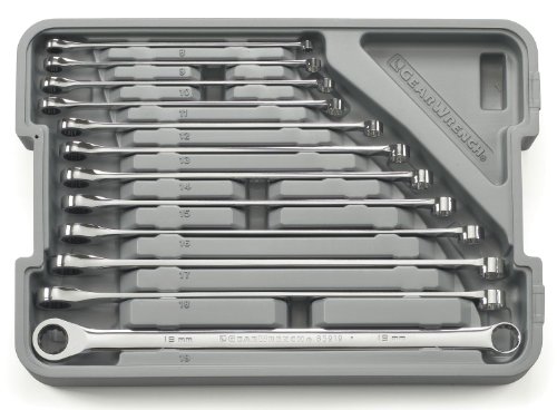

Hi GJ, this board has always been very useful to me. I usually just google my general questions but have decided to sign up before I drop some dough on a quality wrench set.
As a hobby I wrench on cars A LOT, and I mean A LOT. Especially older 80s and 90s vehicles. I live in Toronto, Canada where rust can be a problem and am tired of not having a properly good wrench set.
I'm a very tiny guy (~110lbs) so I really appreciate the longer wrenches, and these new comfortable handles.
So there are four things I am looking for, and maybe they can be found in one set, probably not, and that's OK:
1) What are the best performing open end metric wrenches (can be a combination wrench)? I don't care if they mark my fasteners.
2) What are the best performing metric box end wrenches (can be a combination wrench)?
3) What are the longest box end metric wrenches (can be a combination wrench)?
4) What are the most comfortable wrenches to use (I've been reading about various manufacturers who make nice thick comfy handles)?
The main purpose of these wrenches would be to break fasteners loose, I usually then finish the job with a Gearwrench flex ratcheting wrench or a ratchet. I understand I might have to buy more than one set to fulfill these needs, and that's fine.

For double box zero offset you're best off buying the Gearwrench set. It's identical to the one that matco sells for much less. Other than that Snap-On and Mac sell non-ratcheting versions. Personally I plan on buying the Gearwrench set eventually.

I then eliminated Cornwell as they had no special anti slip feature on the open end. I eliminated Snap-On and as their prices in comparison were just ridiculous. MAC didn't have a proper full set of of sizes in their long versions, and their prices were ridiculous as well so I took MAC off the list. I REALLY liked wright's pricing (~160 for their HUGE full metric set) but not the length of their sets so it was between Proto and Williams.
I really wanted to go for the Williams SuperCombo set as everyone seems to praise their beam design and anti slip feature on the open end. In the end however I decided on the slightly longer set of satin finish Protos as they had very good reviews of the anti slip but mainly because they offered a 10-19 set with a 6 point box end. This is very useful for me as I work on rust buckets very often. I decided on the satin finish for it's anti slip characteristics. If it weren't for the 6 point box end on the Protos I would have gone with the Williams SuperCombo.
For the extra long box I decided to actually go with two sets. It's very hard to find a full set without missing sizes (I'm very OCD about that) with good length and zero offset. So I decided with the Gearwrench Gearbox set and when I don't want to carry the huge Gearbox set I've also decided on MAC's extra long zero offset double box wrenches in 8x10, 12x14, and 17x19 (since I mostly work on Japanese imports). It'd be nice if I can find a 22x24 to complete the set, I'll be keeping my eyes peeled on ebay.
