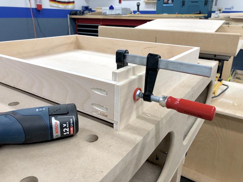

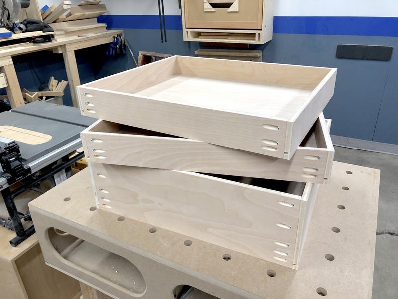

Absolutely adore my K5 Kreg Jig. Put it on credit, you won't regret it. The built in dust collection is retardedly awesome, too.
Nice pieces of kit also, always buy the best you can afford, it's cheaper in the long run.
Nick,you've really perfected your manufacturing process there mate, beautiful work.Nice pieces of kit also, always buy the best you can afford, it's cheaper in the long run.

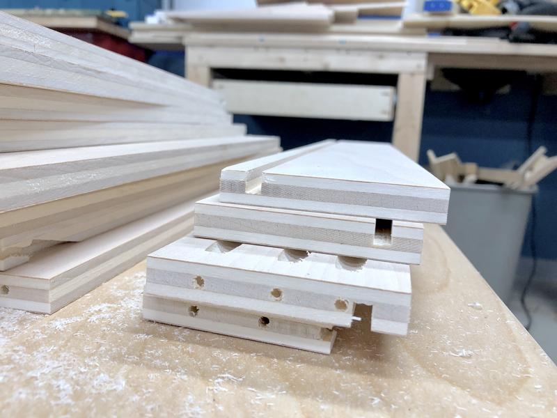

Nick, I suggest you try out the Whiteside drawer router bit...

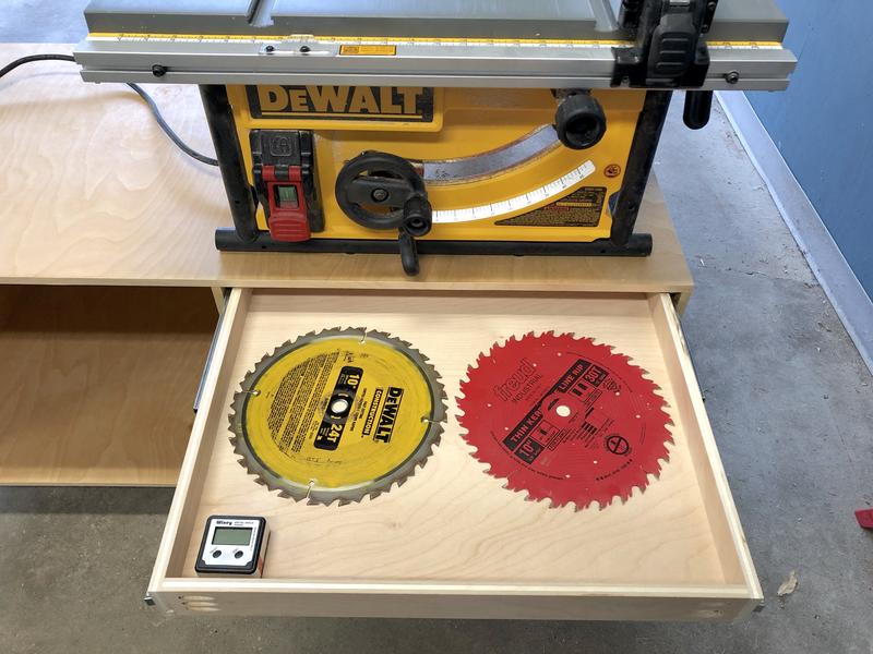

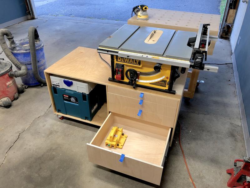

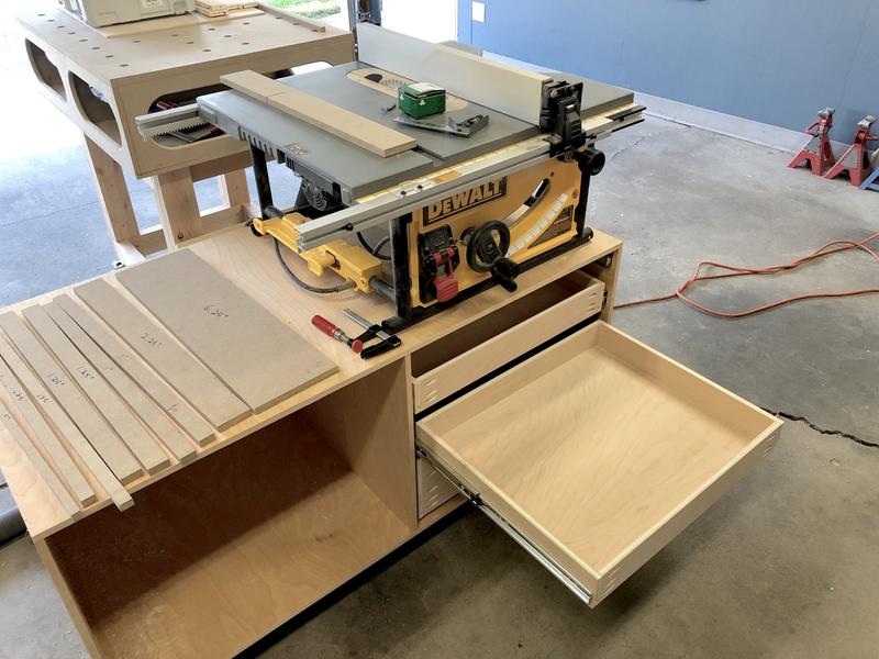

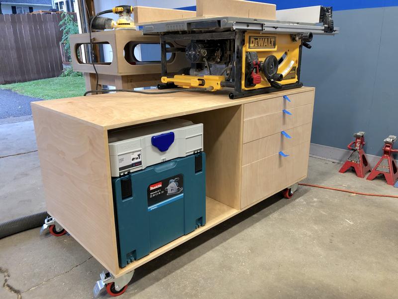

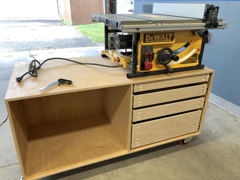

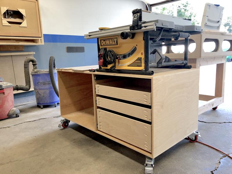

That Table Saw set up is coming along nice!

Thanks for the suggestion, that does look slick. I was looking online and it seems there are a couple different ones. Do you have a link to the one you use, or prefer? I do have a DIY router table but no miter slot yet.

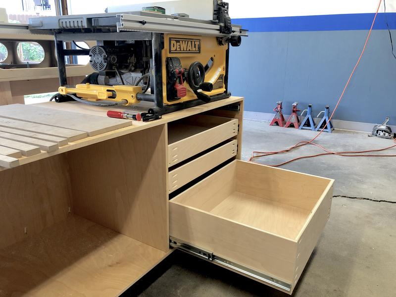

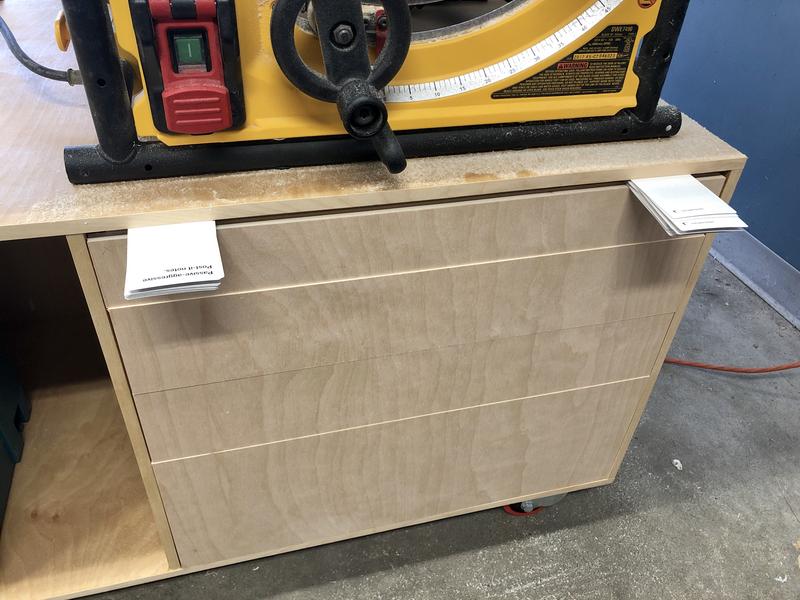

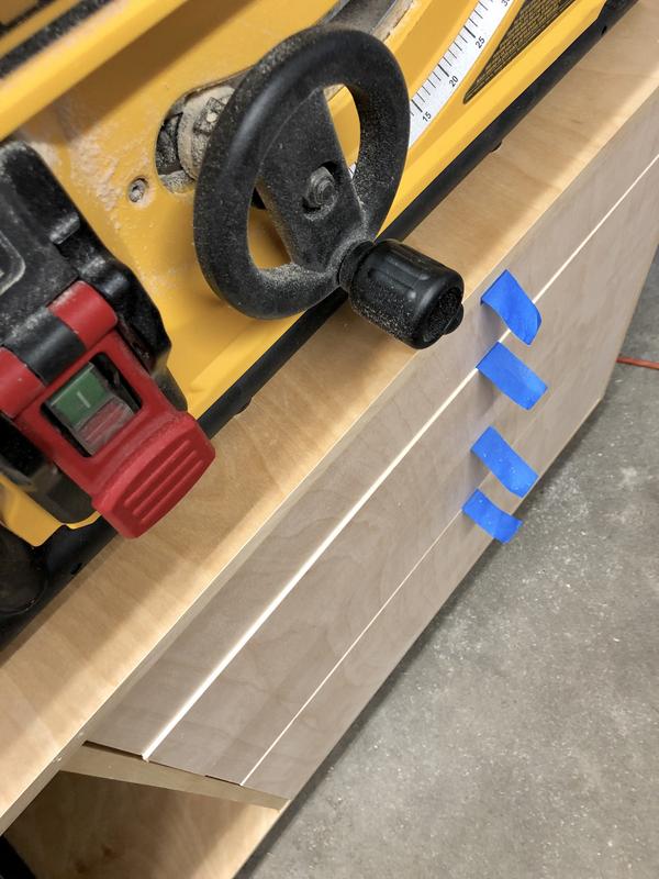

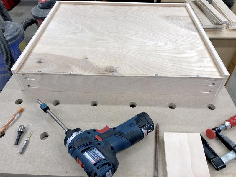

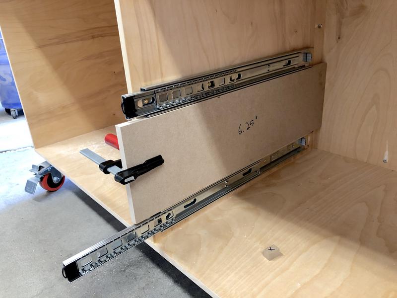

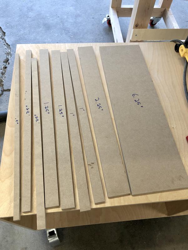

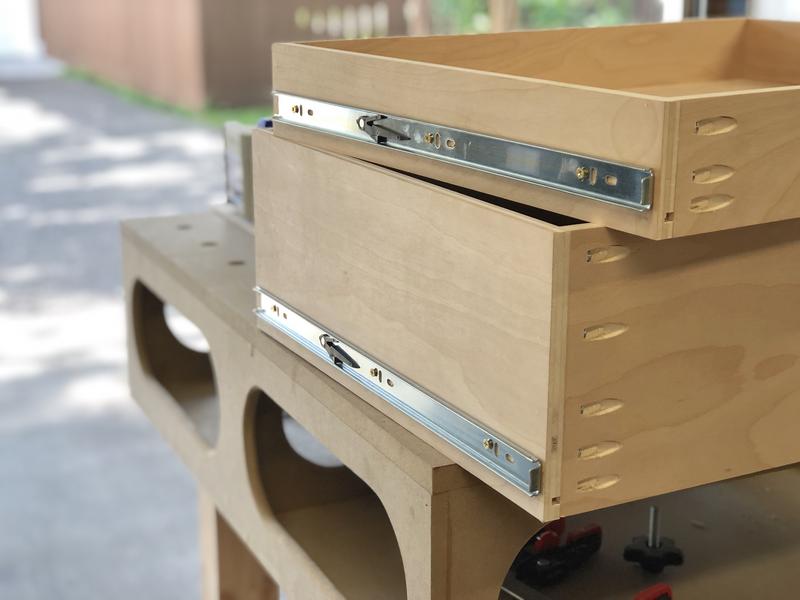

Installing drawer slides is time consuming as hell, especially once you start needing to shim them a bit here and there. Looking good tho!
Nick, thank you and there are two Locking Drawer Glue Joint bits available. The 1/4” shank is the 3346 and the 1/2” shank is the 3347. At this point in my wood working hobby I have only ever purchased and own 1/2” diameter shank router bits. Both my table and plunge router have 1/2” and 1/4” collets but I have always bought the larger diameter bits for the strength.
Thanks for the info! I'll look into this. Agree on 1/2" shank bits.

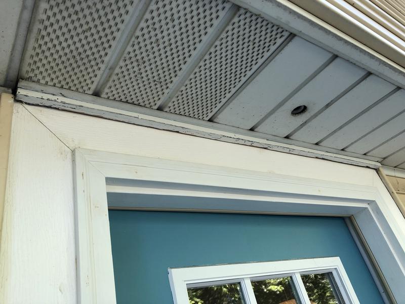

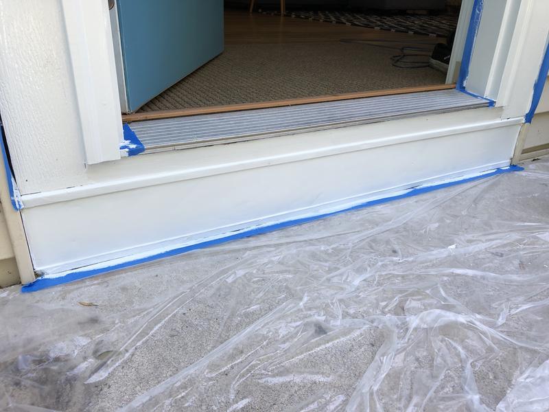

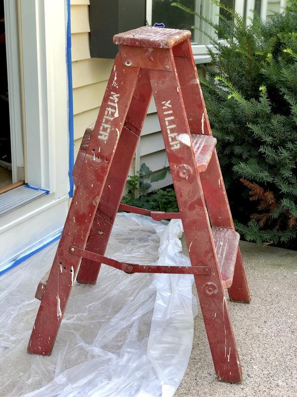

I do love shiny, new, pretty, efficient tools like the Woodpeckers stuff, but I also like used tools. I have a few beat up tools that have seen a lot of use, a few that I inherited from my dad. Nothing "special" in and of themselves, but special to me. I thought I would highlight one of them I used on the door yesterday: this small red stepladder.
LOL at the CAH playing card spacers.

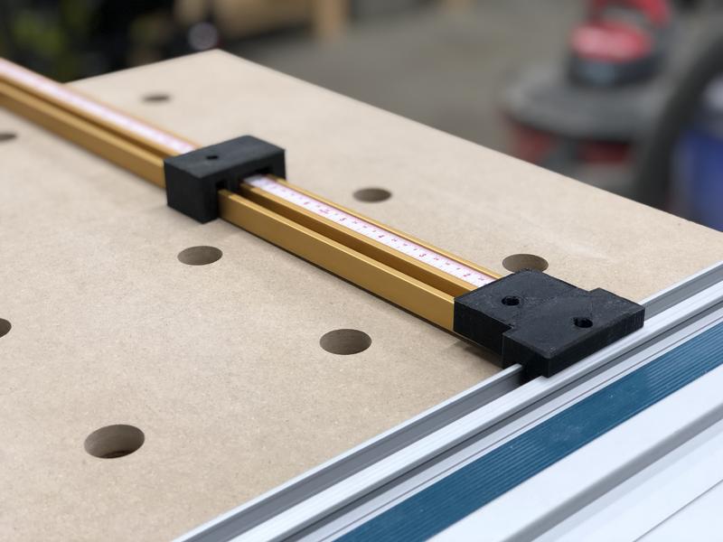

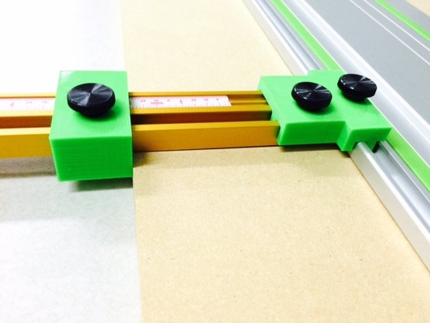

Yes, I'm familiar with TSO products. Looks like nice stuff. The fact that you can use with the rail square and only use one parallel guide is clever. The trouble for me is it's $$$$. The very cheapest configuration including the rail square is $308 which is scarily close to what the track saw cost in the first place!

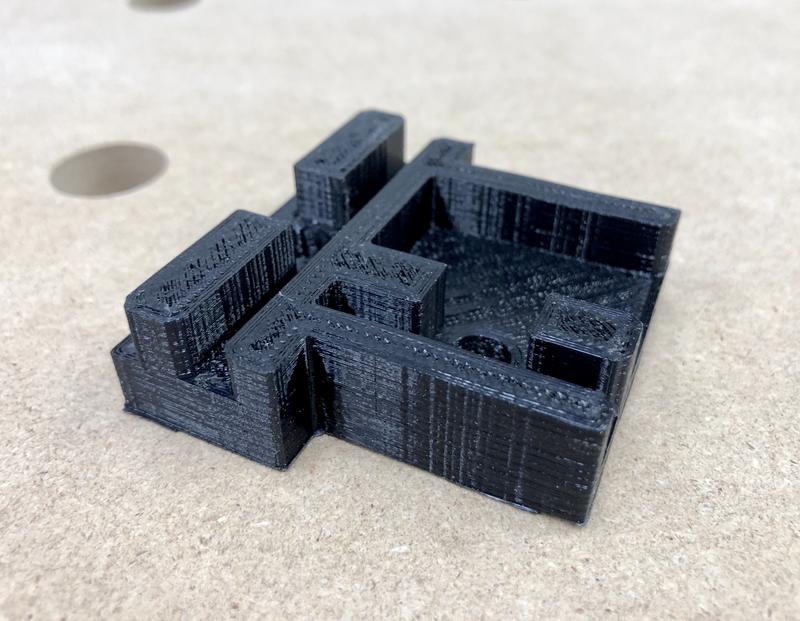

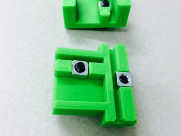

The ones I'm DIY'ing most closely mimic the Seneca guides, and use Incra TT+, which is accurate and relatively affordable. I still need to pick up some hardware for my 3D printed parts but this is the idea:
They won't do narrow ripping like the Seneca but I have the table saw for that.
I'll have to come back with a final verdict on accuracy after testing, but the 3D parts were essentially free and fit the track pretty well.

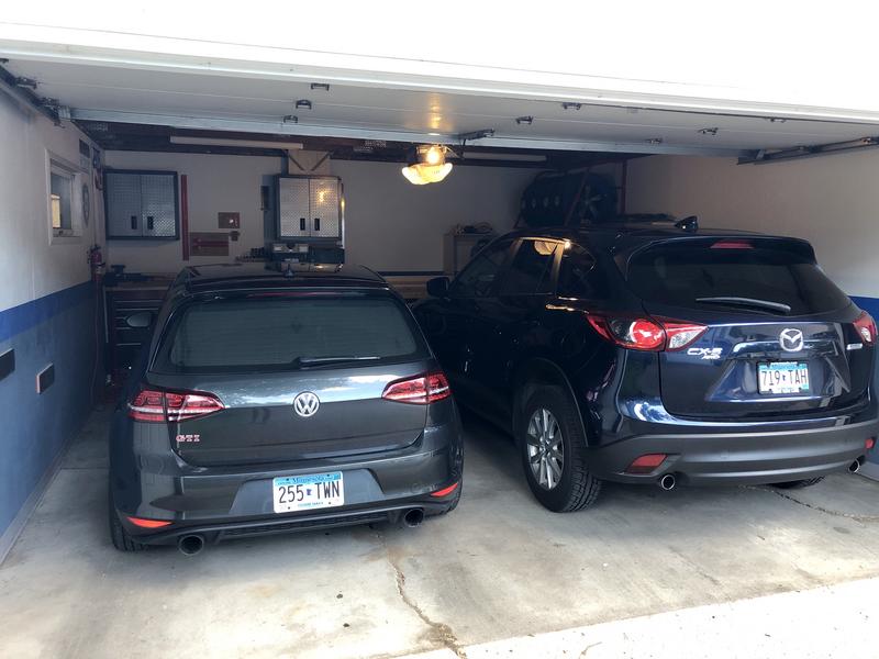

I do still park both cars in the garage, and yes it is filling up.

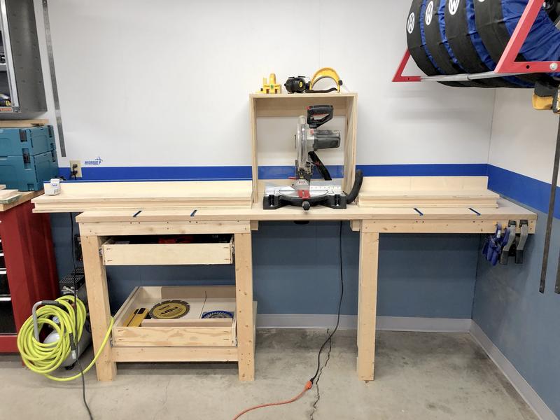

The whole back wall is full and there's no way we could have larger cars and still park in there. That's why I'm planning on getting rid of the miter station, and building a new one that can house the table saw and another mobile workbench underneath. I'd love to dedicate half of the space to woodworking, but I have a shared driveway and can't really park outside on my property. I'd have to street park in front of the house, and while a lot of people in my neighborhood do, I don't love the idea of that. Plus, I never want to go back to scraping ice and snow off the cars in the morning during winter, not to mention it's too cold to work out there almost half the year anyways, so preventing myself from parking inside in the winter wouldn't even be that fruitful. For now, the garage will still serve it's core purpose, a shelter for the cars.
Yet I keep having the desire for more tools, more workbenches, more storage. There's a lot of bigger items on my wish list like jointer, planer, drill press, band saw, sanders, biscuit joiner, hand tools, clamps, etc. But... I need to figure out how far I want to take this woodworking thing and if I have the time and money and space to support it. Having a young kid as I'm sure you know makes it tricky to build complicated projects or furniture on the regular!

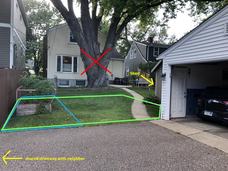

I don't think I've showed many pics of this but here is the shed to the side of the garage:
Hey Nick, fellow Minnesotan here, I've been following your thread for a while now. If you are serious about removing the shed, I might be an interested buyer. What size is it?
Hey! It's 10x12, but unfortunately I'm not serious about getting rid of it, in the short-term anyways. If I did, I'd need to replace it with another solution, and I don't have the excess time or money to make that happen right now with the little one. Thanks for the interest, though!
