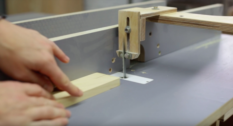

In a stroke of luck, I got off work early today and was able to spend about 3 hours in the garage. I decided to keep working on the router table.
A LONG time ago I had bought some t-track for attaching the future router table fence, so I thought I would install that, finally.
To start I did some layout:
View media item 92082
View media item 92081
At first I was worried this Woodpecker 12 inch T-square would be awkward. Too large for working with small boards, and too small for working with sheet goods. But so far it's been pretty useful. It's so easy to lay out perpendicular and parallel lines very precisely.
My plunge router wouldn't fit under the cabinet shelf so I had to take the table surface off to route the dados. Since I had it apart, I decided to fix an issue I had previously when installing the lag screw "hinges". One of the oak sides separated when putting the screw in, so I sanded down the surfaces and re-glued it.
View media item 92079
View media item 92078
Since I had to wait for the glue to cure, I randomly decided to make a screwdriver holder from a scrap piece of plywood. Normally my screwdrivers are in this drawer:
View media item 92067
I'd like to get another organizer piece, and put the screwdrivers on the wall where they are easily accessible and not rolling around in a drawer.
I cut the plywood on the table saw and then rounded the corners with a jigsaw and orbital sander.
View media item 92077
Then I glued a riser for the back row of drivers.
View media item 92068
Ok, back to the router table. With it back intact, I started routing the dados. Set the plunge to a hair deeper than the t-track.
View media item 92080
Then I used the t-track itself as a straight edge guide, pinned down by the Festool quick clamps.
View media item 92076
View media item 92075
View media item 92073
I've really come to like these clamps as they are very versatile.
View media item 92072
I overshot my line a bit. Oooops. :lol_hitti
To square up the stop dados I had to do some chiseling with my crappy Home Depot chisels. I'm not very good at chiseling, and my chisels are cheap and NOT sharp, but I did watch a YouTube video recently and tried to improve my technnique. It's just something I've hardly ever had to do so I don't have much practice.
View media item 92071
View media item 92070
View media item 92069
Not horrible, I guess. Like a lot of shop projects I've made, it's functional, but not perfect aesthetically.
I cut the t-track on the miter saw and screwed it in. I have yet to make a proper fence, but here you can see the Festool clamps actually fit the t-track so I can just clamp a straight board in the meantime.
View media item 92066
View media item 92065
And here's a preview of the screwdriver holder:
View media item 92064
I brought both projects inside the house to apply some finish when I can get to it.

I finished the screwdriver holder today. I filled a few voids with wood filler and then did two coats of minwax clear wipe-on poly.
There’s some extra room for a few more drivers if needed. A very simple project but I really like how it turned out. I’m now inspired to make more tool holders and get stuff off my workbench. Even though I’m a person who really likes to be organized, I’ve put off organizing my workbench drawers or hanging stuff on the walls because I felt like I was still acquiring tools and didn’t know where to start. With the screwdriver holder I think I realized I just need to start somewhere, even without a complete plan in place, or it will never happen.

While I put the poly on the screwdriver holder, I also wiped a couple of coats on the router table surface. I wasn't sure if or how I should put a finish on this, but I'm glad I did.
View media item 92157
It looks really nice (in my opinion). In fact, it makes we wish I had bought nicer plywood for the cabinet / made it more aesthetically pleasing.
View media item 92156
I re-installed and just for fun laid a straight edge corner-to-corner both ways. I was pleased to find it's still pretty darn flat. Good enough for me, anyway.
I think I'm going to work on the fence next, as time allows. I was planning on making that from MDF as well, and I ordered some 12" sections of Woodpecker's Super Track for the sub-fences. We'll see how that goes.

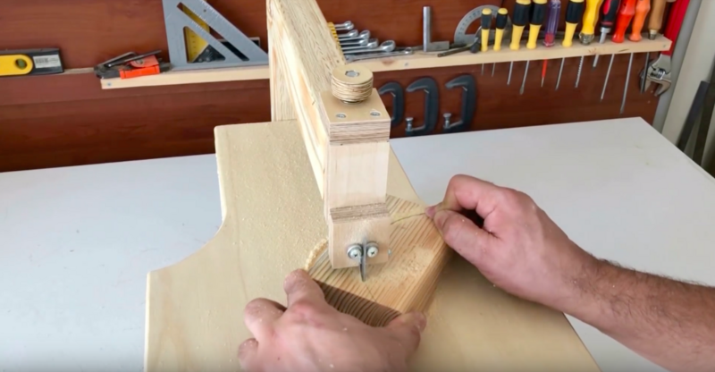

As I've been making the router table I've long had the idea to copy Garage Journal user Lilscorpion's "router buddies" (although with much poorer execution than Lilscorpion :bowdown:). Basically, the idea is interchangeable insert plates and tools that utilize the same worksurface and fence. It makes so much sense to me in my limited space to have one setup that can encompass multiple tools. And I like the modularity of it.
The other tools I'd like to incorporate are an inverted jigsaw and an oscillating spindle sander.
For the router itself I'm using a Rockler phenolic plate as I'm sure you've seen. These go for about $50 a pop, and since they are made for routers, would have to be modified for other tools, anyways. I thought I would try making my own insert plate out of MDF both to save money and have a custom solution.
So I traced the Rockler one on a piece of 1/2" MDF, and cut it slightly oversized with the track saw:
View media item 92570
I could have easily done this on the table saw, but the track saw is easier to take out and set up, and has better dust collection on the MDF.
View media item 92571
Then I clamped the Rockler plate to the MDF as a template, and flush trimmed it with a pattern bit. Because I was using my only insert plate as the template, I had to do this handheld instead of in the table. But future plates will be easier to replicate.
View media item 92572
View media item 92573
It's a tight fit!
View media item 92575
View media item 92574
The Rockler plate thickness is in-between 1/4" and 1/2" stock so I used 1/2" MDF for strength which is why it's sitting a bit proud of the surface. I don't want to have to adjust the plate leveling screws when swapping plates, so I'm going to remove some material from the underside of the corners to get it flush.
Seeing as I don't have an oscillating spindle sander, this one will be for the jigsaw. :bounce:

On to the important stuff. Continuing on the inverted jigsaw insert, I did some layout on the bottom of the new plate, and cut some pine strips to frame the jigsaw base in place.
View media item 92657
Then I glued and clamped it. Clamp city!
View media item 92656

And here's the current status of the jigsaw plate:
View media item 92646
View media item 92645

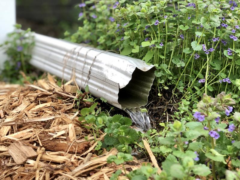

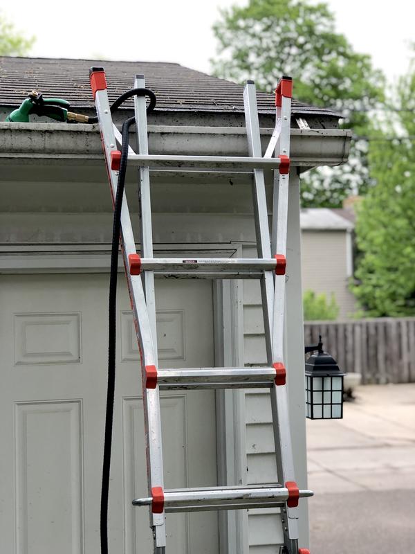

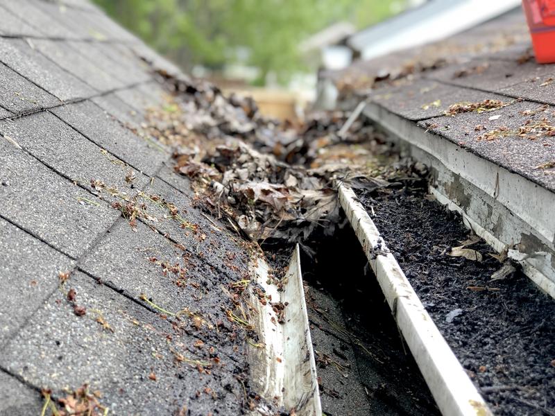

As part of Spring maintenance I cleaned out the garage gutters yesterday. Didn't have an opportunity last fall and we're getting into the rainy stormy season here.
There was was an inch-thick blanket of organic matter on the foam gutter guards, but they seemed to do their job well.
I cleared everything, washed out with hose, and then ran the hose in the gutter to make sure water was flowing well.

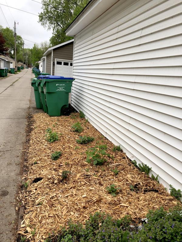

Got the raspberry bushes planted on the alley side of the garage a few weeks ago:

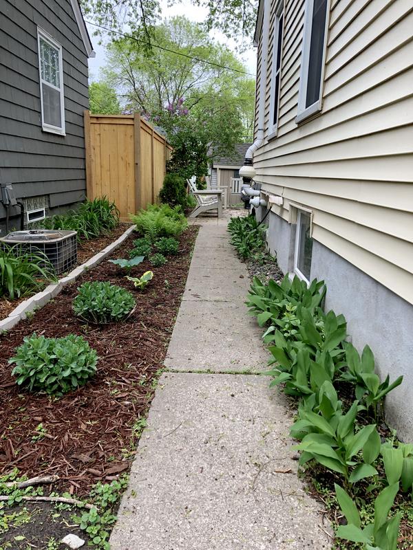

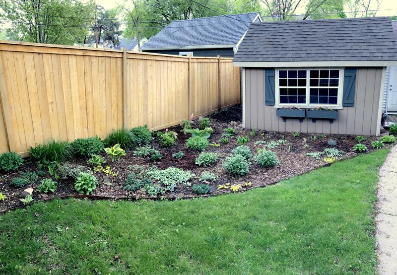

And the wife's been working on the gardens, moving some plants around. Here you can see our little shed where I store yard tools and other random bits that don't have a home inside the garage.
It's nice to actually see green things and not snow!

Outside yard looks good!
Bret
Thanks Bret!

Nick,nice work with the gardens, it all looks good. :thumbup:
The router table/box has come along a treat, jigsaws are not my most favourite tool,I'm looking forward to see how that works out.:)
I think what you really need is a nice little spindle moulder (shaper?) with maybe a sliding table, so you can scribe on it.:lol::lol:
Have a good week.
Steve:beer:
N
nicholam77
Dec 18, 2016
2,669
Minneapolis, MN
Have a good week.
Steve:beer:
Thanks, Steve! Although I have to give credit to my wife for the gardens, it's almost entirely her project.
I don't love jigsaws either :bounce:
Maybe it's my technique, but the blade often bends when I make cuts, don't always follow my line, and sometimes it's hard to support the workpiece.
I'm hoping inverting it in a table will solve some of that. I'm also intending to use a homemade blade guide, like a bandsaw in a way. See below screenshots (or hit the YouTube links if you're curious) to see what I mean:
I don't know how well it will work, but that's the idea, since I don't have a bandsaw and it would be nice to make better, curved cuts sometimes. I have a particular project in mind for it.
Could you elaborate on the spindle moulder/shaper? Is that the same thing as an oscillating spindle sander? I was thinking of getting one of these handheld units to mount upside down in the table, too:
What would the purpose of the sliding table be? Funny you mention scribing... I also have another future project that will require some scribing to walls, which I've never done before. Not sure if that would work for this, but I'm interested.
