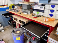

3D Printed Socket Organizers — Part 3
The printer has been busy and finally I've got all the trays:
They took between 8-10 hrs a piece and I had to reprint two to fix some dimensions.
As you can see I had some success with the two-tone labels.
I used the combination of a "Pause At Height" in Cura and a G-code script in Octoprint when it captures the pause command. It seemed like not all the G-code in the script ran correctly, there was supposed to be a retraction and unlocking the extruder motor, which did not work. So I had to carefully swap the filament and purge it by hand. The trickiest part was the pressure built up from purging and the nozzle oozing before resuming.
On the SAE index it did not print the slashes in the fractions, or part of the number 4:
And not quite as clean as the Metric. The slashes etc are present in the .STL, but not in the sliced file. My theory is possibly they are thinner than the 0.4mm nozzle and therefore not included? Or maybe a random bug? I don't really know but I've printed these indices enough times where I'm not to eager to troubleshoot at the moment.
In hindsight I would have left a little more clearance on the sockets to make them easier to remove, but I don't think it's worth 40-50 more hours of printing to redo.
The ratchet and extension tray came out nice.
So here it is in the drawer:
I might make some additional trays for some of the other bits in there.
