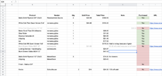

I'm a fan of 80/20 theory in most things. 80% prep and 20% execution leads to excellent results.
Of course being a fan of the theory is easy. Actually using it in practice is something I'm guilty of failing to do on occasion.
As an absolute certified Excel Junkie who lives it and loves it every day, I love seeing spreadsheets used for non-day job activities. I won't comment on the blasphemy of Google Sheets I see some people using...:devilish:

I use Excel for EVERYTHING!
I've used it to make blueprints! I've used it to write up a budget for our family. I've used it to make workout lists. Packing lists. It's just so damn useful for everything.
In my defense I don't know how to use Excel (or Google Sheets, really). Google Sheets works for the very, very basic use case I need it for.

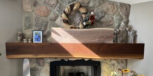

Thanks for sharing those pictures from the home tour. Although I don't think I could ever get my wife on board with a home of that style, I love the look and appreciate the design. That 3rd one, to me, was the best of the bunch.
And the nightstands are coming along nicely. I'm always impressed by the woodworking skills on GJ, as I can't cut a board straight to save my life.
No problem, glad some people found it interesting! I think Modernism in residential architecture is very polarizing. Either you love it, or you don't. Obviously it's extremely pervasive in the public sphere — offices, skyscrapers, banks, schools, even churches. In residences, though, I think it was largely a failed experiment over time, outside of enthusiasts today who still appreciate its goals. Most people do not live in, or do not want to live in, a Modern house.
Many people refer to Modernism as a "style", and I understand that, because most Modernist buildings follow similar visual restraints like "clean lines" and "open spaces". But there's a quote I came across that I really like that says something along the lines of "Modernism is not an architectural style, but rather an abstraction of design principles". Which is true. It's not limited to a certain form like Arts & Crafts, Spanish, Tudor, Colonial, etc. Those all have a specific toolkit for what they should look like, and it's fairly strict. Modernism on the other hand is more about the ideas behind it — natural light, indoor-outdoor living, connection to nature, lack of adornment, etc. The form these take can be extremely varied. If you look at buildings by Le Corbusier, John Lautner, Frank Lloyd Wright, Oscar Niemeyer, etc, they are all considered Modernist architects but their buildings look wildly different. Even the houses on the tour were quite different from one another. When I first realized that it was eye-opening to understanding the movement better.

Sorry for the delayed response, Nick. I didn't see the Monocoat in the color I thought was a good match (smoked brown) so I threw out the precolor. Upon closer inspection, they do have the Monocoat in smoke and a bunch of other colors. I've only used the Pure - no color.
Here are some examples of the Monocoat Pure 2c on a Black Walnut slab with indirect and direct sunlight compared to a raw slab of Black Walnut (not the same tree):
In this pic you can see it does 'pop the grain' a bit, but not as much as the Danish Oil in your trial.
Off axis:
Good Luck!

@Trapps (Mark) — thanks for the pics. Your mantle looks awesome. That looks nice and flat to me and seems to match the grain definition in my bed. I've read that Monocoat Pure and Osmo look almost identical, so I just need to figure out which one is cheaper to test some colors with.
