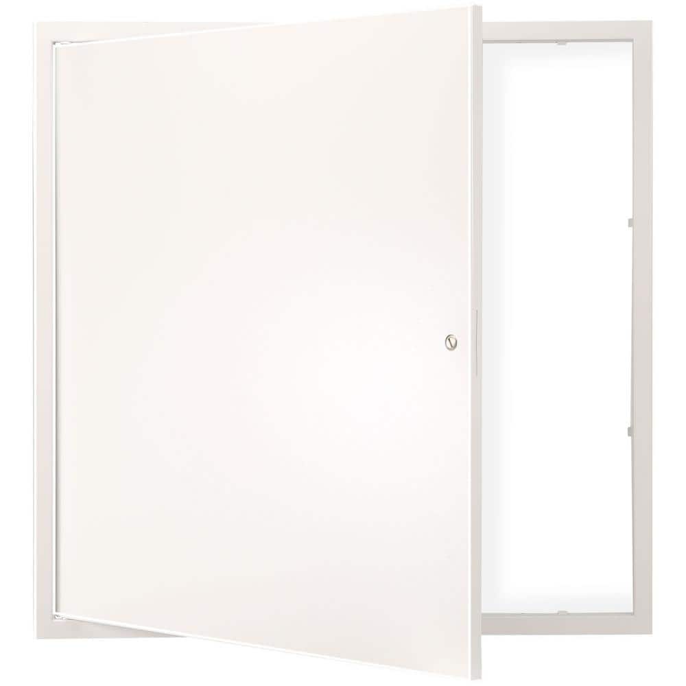

Now I just need to make an access / cover up panel for these random holes I cut in the office ceiling when I had a frozen water pipe a long time ago 🤣
One day...

They sell these for potential repeat offender holes.
Thanks for the link, Kay. That looks about perfect, I think 16x16" is right, too. Definitely want to keep access in case I have another freeze up (water line takes a bend there up to the kitchen sink on an outside wall). I think just having those holes exposed to the basement air has prevented a further incident, but we are looking at another cold front this weekend with single digit negative highs and double digit negative lows.
I thought about trying to make an access panel from MDF or even 3d print, but at $22 it probably makes sense to just buy one.

...I think just having those holes exposed to the basement air has prevented a further incident...
If you wanted to still allow warm air on the pipes during the winter and have it accessible in case of future issues, maybe something like this would make sense...
Granted, it is a little hacky and I'm not certain if it would violate some sort of building code, but just tossing the idea out there.
That's exactly where I was going once I read about the pipes and the outside wall. You beat me to it.
Make sure you face the little openings towards the wall, so they're not as visible.
