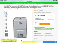

My basement shop is cool in the winter. I added a small 45k btu 95% single stage furnace running on Nat gas 7 years ago before prices on furnaces went up. If I was propane I would do the same today.
Example of what I installed not the same brand but the unit was FEDEX to my door.
PVC a venting, plenum and duct work was minimal. Think mine was less $800 all in again a few years back.
