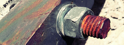

Why should we think this rusty left hand thread screw is stainless steel?
And why would we think that the slightly rusty steel bar it goes through is aluminum?
Those probably aren't, hence the rust. But the galvanic rust also spreads on the stainless steel. It also even happens between different types of stainless steel.
