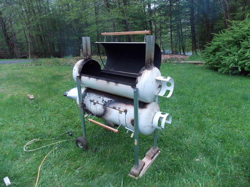

brianh
Apr 6, 2010
1,299
grahamsville NY
I always have some in the shop comes in handy.
I bend large hooks for the wall for hoses and extension cords, canopy awning for my art show trailer. Small green house.
BBQ Legs and air intake pipes wood forced air fired burns my hardwood scraps. I have since painted it black.
