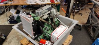

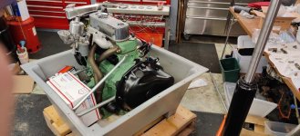

I used some short sections as braces for this engine going across the country.....still have to put the top on the box of course.
Flatten the ends, drill holes for the bolts, bend as needed.....done.
