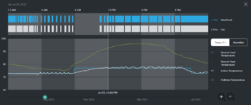

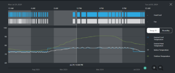

Yes, that's the case with my house. The temp start rising after sunrise... I can keep the thermostat at 50 degrees, it doesn't matter, it just goes up and the best my system can do is to keep it at 77-78 though not too long ago when we had a 100 degrees outside, the inside was at 80 until sunset. My ducts are R3 rated I think. My house is 13 years old, I think if I can get another year out of this system, I'd be ready to replace everything with something better though I'd like to have proper calculations in terms of what I really need and what to replace it with exactly with efficiency in mind.

Here's a typical day in my house from this week:
and here's last year:
The system is running longer this year vs last year (don't have July report at the moment):

well according to these graphs your system is working pretty well and not at 100% capacity.
why're you setting back to 77F at 8am? you've got nearly 4 hours of uninterrupted off time that could be leveraged for comfort.
if you want to convince me with data your system is inadequate, show me the graph when the setpoint stays at 72F the whole day.
that aside, if you're looking to make an investment in it, I'd suggest blowing in more insulation. that's relatively inexpensive, and if the ducts are under some insulation, their effective R value will increase.
yeah it works "well" using the scenario I programmed into my thermostat
because the system is physically incapable of keeping up with 73 after 8 AM... Look at the green line on my graphs (outdoor temp) anything after 8 AM is when the system starts fighting heat resulting in running non-stop all day wasting electricity; the heat will eventually 'win' and the indoor temp will rise to 77 regardless of what I set the thermostat to.. The only reason it kinda sorta works for us is because no one is home after 8 AM. So, since the system can't keep my indoor temps at 73 all day, there's no reason setting thermostat to anything lower than 77... At least it cycles through and doesn't run uninterruptedly.
