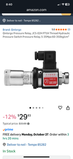

So I got this pressure switch. The listing says 1/4 NP thread. Google brings up one site that says it was an old Japan spec. And is not compatible with NPT. NPT seems to fit ok. Send it?

-Thread pitch for 1/4" NPT is 18 TPI and thread angle is 60°. If your pressure switch thread geometry is BSPT (JIS B 0203 for tapered pipe @ 55° and 19 TPI) then they may very well seem to fit together due to the thread angle difference but I wouldn't expect them to seal properly. Excessive tightening to attempt sealing may also deform the threads in the switch. "Only 3000 psi" so what could go wrong? Your call.
-If made in China they did alter the standard thread pitch to be NPT compatible a while ago but reports I've read advise to test anything made in China before acceptance/purchase.

...The listing says 1/4 NP thread...
Before I searched out specs for the part you displayed, I did some searching for Japanese NP thread, and that was pretty misleading, because the thread ending in "P" is likely to be BSPP (i.e. parallel and not tapered thread), which is an entirely different animal.
Now look at this listing:
It says Connecting Type: PT1/4 Thread
And when I search that out, I find out that JIS type PT thread is for your purposes BSPT.
You will need an adapter. And for more information on that:
Note that the above diagram shows either 1/2 or 3/4 threads, where the pitch is 14 TPI for both BSP and NPT. In 1/4" pipe threads, the two systems use different pitches from each other, so while you may be able to get helical leak sealing with a lot of sealant in 1/2 or 3/4, at 1/4 you will not get full thread engagement, so you have bigger problems that just sealing.
