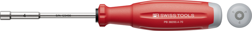

I thought PB Swiss' approach showed a good degree of thought - only the sizes from 8mm up have a hex bolster.
This aligns with how much torque a hand can comfortably apply to a screwdriver handle (5-6 Nm), and commonly recommended max torques for metric fasteners (M5 with an 8mm head is max 6 Nm).

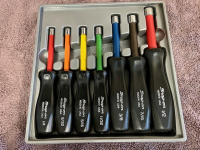

Old Gen Snap-On sets work great. I don't use them a ton, but they do come in handy in certain applications.
And loaded in a custom tool roll.
I must comment that both those Snap-On nut driver sets (SAE & Metric) are stunning and beautiful and must be a joy to use! :love:
willf650
Mar 10, 2010
1,021
Actually not really. They suffer from the same affliction as the craftsman ones. The handles are tiny for what you are trying to turn and are difficult to grip adequately. I’ve used those before.
