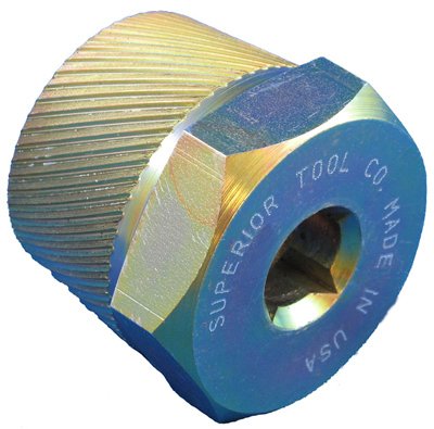

bought a new house and the shower drain is disgustingly rusted. I want to replace it. However, inside the drain there's no "cross beam" type thing for a drain removal tool, and no notch in the flange, or anything alike to be able to spin it out. How do I know if I have a press on flange that's not replaceable?

i actually tried that haha, i just couldn't get it to seat right. I actually got it to come out! it was a normal threaded one (albiet cheap version). Method was using a roofing hammer with the claw inside the drain and using the handle for leverage to turn the drain out. It took quite a few trials and the old drain eventually split into pieces at the threads, but I was able to scrape all of it out of the drain. new one went in like a glove and we are good to go. A little bit of soft scrub on the tub and i won't feel like i'm going to get tetanus or something ha.

I have one of the tools in post #10 . It has worked for me numerous times. I have 12 drains on concrete slabs plus 12 more on second floor. Works every time for me. It is left hand threaded and simple to use. Once in a while I need a breaker bar to loosen it and I am afraid I will rip the tub but I have been lucky so far. I only learned about this handy tool a few years ago so I am sharing although the poster has solved his problem already.
